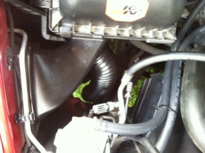

3" x 2' Flexible Air Intake from AutoZone. The air box still draws air in from the original intake (behind the wheel well) and now from just below the frame. There is a cable tie holding the bottom end of the tubing to the frame.
I've got nothing too lose and I didn't have a extra 300.00 to spare for the real deal. This cost me 19.99. I'm not planning on breaking any land speed records. I just wasn't impressed with the small opening it was drawing air from on the original set up.

What I see here in link above, is what most current new vehicles and some older already have stock: A functional cold air intake stock. This particular picture also has an addition tubing added to the stock cold air filter box.
This IMO is not going to benefit in any way. As said, a CAI is there already stock. If the Intake air is drawn anywhere outside of the engine bay area(warm or hotter air) then it is considered a cold air intake. Now the performance on an aftermarket or self made CAI can be grabbed best by eliminating ribbed tubing, upgrading larger diameter tubing, high flow air filter, tubing composition type(plastic, aluminum, etc...). Aluminum if going near engine heat transfers the heat quicker than plastic warming the air... I prefer plastic designs.

Have you seen where the original cold air intake draws air from on a 4th Gen? Its a terrible design using a small area from behind the right front headlamp assembly. My thought was add a 3 inch tube and draw in cold(er) air in without any restrictions from underneath the truck as compared to stock. Been looking for a smooth intake tube for it, but nothing out there. My goal was to create a cheaper alternative CAI rather than shelling out $300.00 or more for a super duper high performance CAI. I think at 19.99, I found it.
Not trying to come across negative, especially to a fellow RF member. I just don't think the engineers in charge of the stock design for your trucks CAI made it where what you did will give it any gains. The Air filter and rest of the intake tubing is still the same dimensions which will only permit so much air in. It is still going to be the same air temperature, except with the risk of sucking in moisture from what the picture shows. I had owned a LS2 Z28 that had a wicked ram-air intake on it going down low... The wrong puddle with a rainy storm had destroyed the LS1 that was in it. I am just sharing my opinion. I still think its great your thinking outside the "box" and looking for cheaper ways to obtain any and all performance upgrades. I do the same.

Glad I could help you with the intake. The truck seems to really like it when cruising on the highway. You will really see a difference on a cooler morning.

Thanks Paul!!! I can tell its a tad more responsive now. Thanks for your original post! This project took a little time and a little money and it was well worth it!

I immediately noticed better throttle response. The truck does not have to struggle for air any more.

Sorry for missing the mid pipe installed prior to my last post. Looks great! Enjoy!
