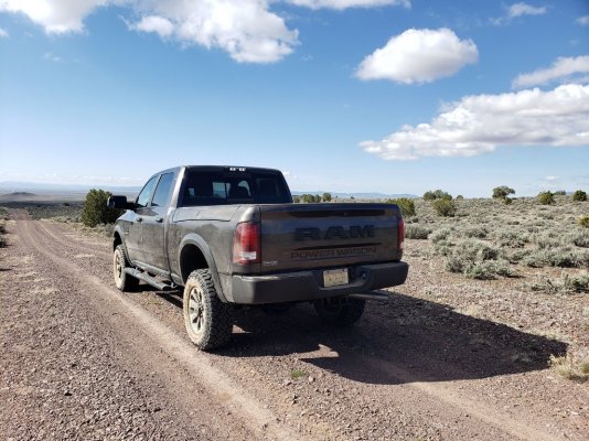

Step 1: Buy a Power Wagon.

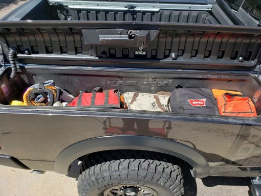

Step 2: Load my recovery gear in the Ram Box's
Step 3: 37s

ARB tire repair kit, first aid kit, recovery gear - shackles, snatch block, 180' of straps, Max Axe Multi-Tool, shovel, saw, sledge, axe, hydraulic jack
Tools, chain saw, branch trimmer, air compressor, air hoses

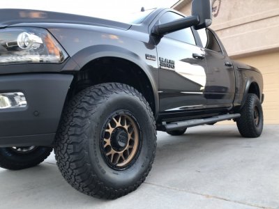

What rims are those....looks nice
Thanks. Those are KMC XD 128 Machete wheels with a matte gray finish with satin black rings. They are 17x9 with +18 offset (5.71" backspacing).

We have matching trucks.. I have KMC’s with the same offset, on KO2 37’s. Was hoping not to trim inner fenders but they rub just slightly. You trim yours?

how do you like the 37 K02?
any chunking or missing rubber?
do they feel heavy duty enough to throw the truck around a good bit? im concerned they wont be as tough as the toyo RT

Nice Truck.:headbang: The tire store trimmed a small amount off of the inner fender liner at the back of the front fender before I even left the store. No rub at all after that.

I like KO2’s in general. I had 2 sets on my Tundra that wore & performed great.
Do not have much experience off-road with them yet. A bit skeptical on the PSI max of 50 on the KO2 & what the truck calls for. I have them around 45 right now and feel like I need to deflate them more. Did a chalk test and they are wearing evenly, just rode a little rough on some washboard roads.
