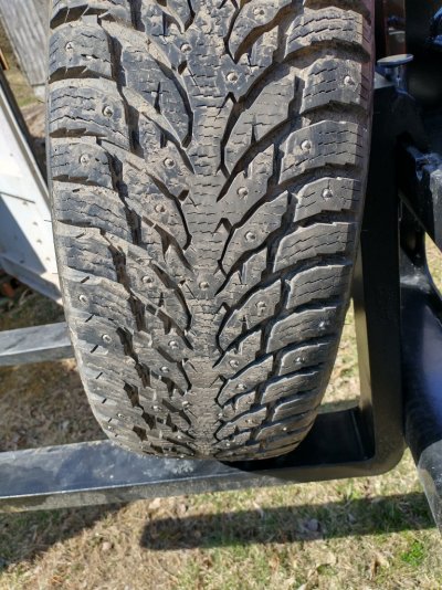

Nokian Hakkapaliita studded with a set of extra wheels. The Hakks are the the cream of the crop when it comes to snow tires. I run two sets, summer and winter. I picked up a set of extra wheels on craigslist with winter tires for my 1500 for $750, 20” fuel aluminums, freakin steal. I see them pop up all the time.
But for true off road snow travel, chains are the best option.

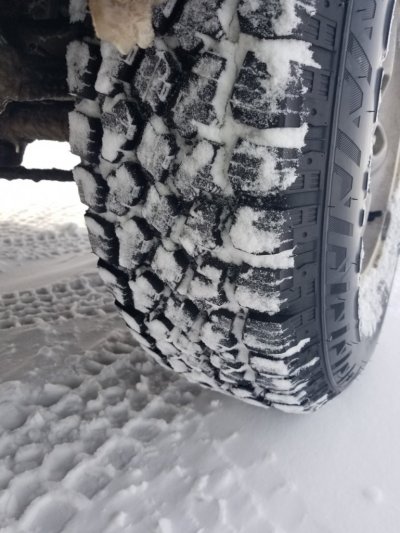

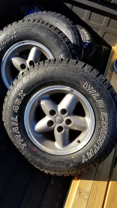

Overall I would get something with more knobs (knobs with sipes). Something balanced between good on-road performance and snow. If you get into wet snow, closely spaced tread won't do you any good. You'll just sit there and spin. Closely spaced is terrible in slush too. You also want to have plenty of vertical tread biting surfaces (lateral to the direction of tire travel). The space between the tread blocks needs to be wide enough to trap snow, and dig into snow, but not TOO wide. That's what makes those Goodyear Kevlars great.
I put a set of these Wild Country 4SX tires (below) on my latest snow plow Jeep. I need good snow traction because we get deep snow sometimes, and I can't be spinning my tires. Need to keep that snow rolling! :D I evaluated a lot of tires before I settled on them. After 3 plow seasons they haven't disappointed. I can personally vouch they are excellent in deep snow, wet & dry snow, and slush. So far I've been tickled with them. Here's what's good:
1) Individual tread blocks that are spaced the 'right' distance apart
2) Plenty of sipes (good in dirt, turf & mud too)
3) Fairly inexpensive
4) Seems like good quality rubber
5) Tread blocks go ALL THE WAY TO THE CARCASS (so they won't seem 'worn-out' when they get down to 30% tread like some tire Co's sneakily do)
6) Lateral edges
7) Not noisy on the hwy
8) Come in a lot of sizes & E Load-Range (if needed)
9) Raised White Letter (a must for some of us!!)
10) FL-based company, I guess (mine were made in VietNam). They produce many of the generic-sounding tire brands.
11) Available at Walmart.com ...sometimes at quite a discount. Keep yer eyes open for sales.

Those Nokians look like a decent all-around tire. But they don't look like they'd be all that great in the snow ....w/o the studs. Yeah, studs make all the difference in certain circumstances (but not all).
You guys can run studs in NY!??? (what are the rules for that?)
So do you use a fork lift to put truck tires on? LOL :D
