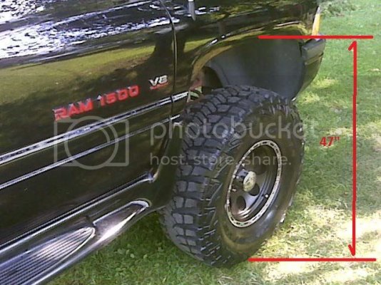

I wish I knew what height my lift was. I'm guessing 6 inches but it looks like more. May just be because of the 3 inch body lift. Is there a way to tell what lift you have?
Get out a tape measure and measure from the ground to the lip of the fender well. Post up your findings and we will help you figure it out.
99jackedram
99jackedram
Mar 1, 2014
26
9
1999
5.2
30 inches from ground to bottom of fender well. I'm thinking it's a 6 inch super lift and 3 inch body lift. What's funny is I was worried about 38s fitting and I still have plenty of room. I had a guy at orileys ask me if those were 33s. Lmao. A little bigger than that I said.
