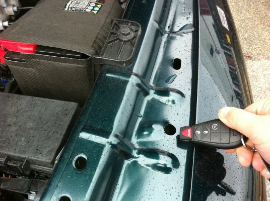

For the headlights thru the hole where my key is pointing uses a torx bit.

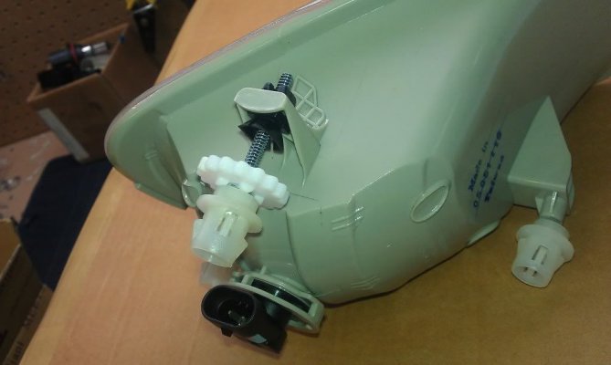

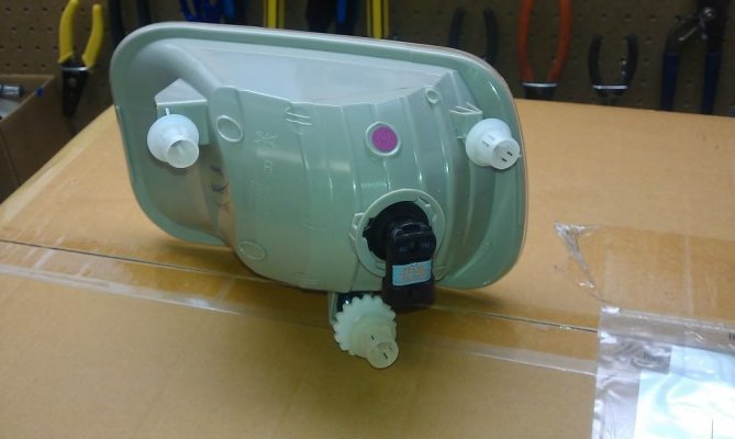

So......I took some better pics. I happen to have a few of these sitting downstairs, they have a date with the oven soon. ;)
These are flipped for better pics
this is how it sits in the truck - there is a bracket that they snap into

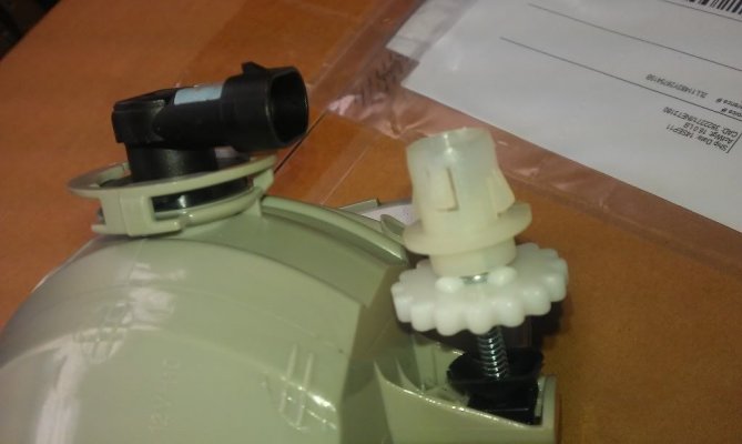

and a close up on the adjuster
