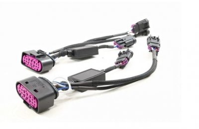

So I got my adapters today. Works like a charm, although there is a third plug that is round and no clue what it connects to.
Any suggestions for HID kits? The LED unfortunately do not fit, so it turns out.
Where did you get your harness from? I got mine from retroshop, and it looks exactly like the one from retrofitsource and from headlightrevolution. See attached pic. There is a plug for the OEM headlight plug and a plug for the OEM parking light plug.
EDIT: I see above you said you got the harness from headlight revolution. That's where I got this picture, and now I can see an extra pigtail. I dont know if there was some kind of update, but mine do not have that. On the retroshop website, it shows an extra pigtail for a "12v connection". It also shows it as V3.0. I got mine from them a couple of years ago and there is no extra pigtail, and I have no issues with my 2017 as is.
