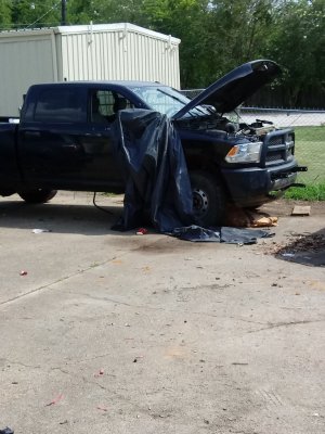

I'm working for a guy that buys cars from auctions and we have a 2016 Ram 2500 5.7 Hemi 4 by 4 heavy duty that was a Louisiana State Wildlife and Fisheries truck apparently it was under water and when I got my hands on it I had to put the front cap back on fenders Hood Grill radiator everything on the front and he replaced the ticm the PCM inside the truck and put a new engine 30000 miles and we have everything hooked up but I have no power inside the truck besides a dome light and headlights at this point I'm not sure what to check besides the body harness itself we do have a 2013 same exact truck but the wiring harnesses are a little different it runs but a tree fell on it so it is completely smashed is there anyway I can transfer anything over to the other truck to get it going or where should I check next. I know that the key needs to be programmed but there's no way anyone is going to touch it with these electrical problems any help would be greatly appreciated I don't know what to do at this point we have over $10,000 invested

Also replace the instrument gauge cluster then I currently have the dash out so I can get to all the wiring everything is connected some of the wiring harnesses are corroded dealer wants almost $1,000 for the body harness not sure what to check next
