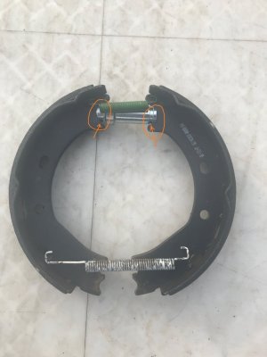

I think it was more your crap shoes or crap adjuster...you can see in this pic how the shoes weren't seated in the slots
