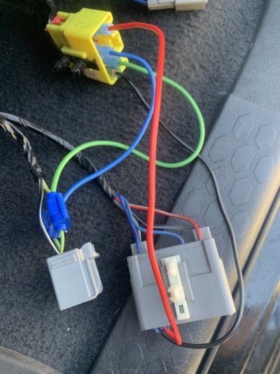

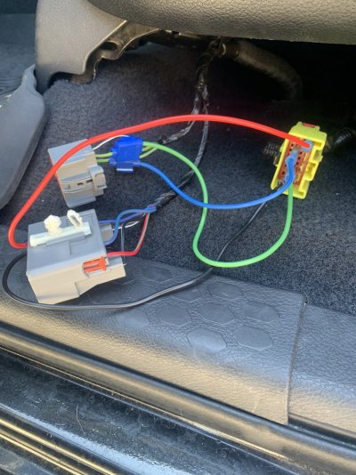

I recently put in a set of front seats from a 2014 in to my
2011. The plugs didn’t match, so I was able to run a power to the drivers side via the power (red) wire, and connect that to the seat by jumping the connection. Seat works fine.
I now have the dreaded seat annunciator light, and chime, along with the airbag light.
I can live with the annunciator lights, but the chime has got to go.
Already tried the disable function, with no avail via you tube university.
Drivers seat is electric, passenger is manual.
Any thought?

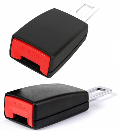

The typical Youtube dinger defeat gets rid of the dinger but not the EVIC popups. If you have Alphaobd you can turn the dinger and EVIC warning off with it. Easiest fix is to put a seat extender in it. Gets rid of ding and the EVIC display both. 2 for 14 bucks. Seat belt is then shown as buckled up permanently.

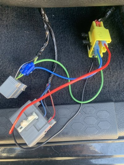

Well, solution found.
Wasn’t hard as there were only three wires coming from the modular under the original seat. Green with purple, green with tan, and Blk.
I did have to cross connect then, but it got the job done.
I’ll clean it up tomorrow, and tuck in under the seat.
Chime no longer goes off, and both annunciator light are off….. as they should be.
