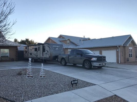

It really depends on what you are pulling. First trailer was 28’ long and was 7900#s loaded. My 1500, with Airlift 1000 airbags and WDH did just fine. Spence trailer is 9950# loaded and it was too much tongue weight wise for my 1500 and to give me some margin in the payload. So I bought a 2500 6.4 Hemi, and it pulls the trailer great and with the WDH set up properly it’s not too bad. However it’s 38’ long so if there is ever a crosswind that’s more than about 15-20mph, I’m pulling over and waiting for it to be done. 3500 dually would pull that trailer with less sway issues no doubt, but it’s not practical for my everyday life and the 12% I actually tow.
9bf81f8bbae6685dd0e111ed5e463da4.jpg3fc15630d07c3809c719d4de22d8e56d.jpg42ae4694c64524d05a8aa8e76fb39016.jpg
