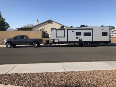

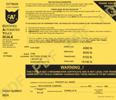

Here is my truck loaded to camp and you can see my camper is only 5700lbs. I have 580lbs til I hit my 10k GVWR. And I have 4660 til I hit 19800 Gross combined. At a 13% tongue weight I could add 4461 more pounds of trailer to hit max GVWR and GCWR. So the biggest trailer I can haul is 5720 plus 4461 for 10181.
You need to be looking at 10 to 11k GVWR not dry.
And believe me...sometimes my 26 foot camper can be a burden. Although the 6.4l does not complain.
