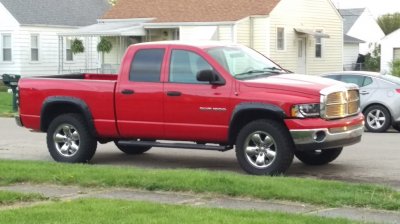

Bought this nice 3rd gen a few months ago because it's my favorite body style. Been fixing it up as I go I'm wanting to lift it a few more inches but I think it's has already been lifted or atleast leveled at some point that's what I need your opinions on. I have Cooper Discoverer STT PRO 35x12.5x20 on it with no rubbing. Ride height is 40" in front 41" in the back. Any opinions on my setup would be helpful.

4wd or 2wd? 2wd's have coil/struts while 4wd's have torsion bars (i.e. front end suspension is different between the two).

sounds like it is just a level. If 4x4 either the torsion bars were cranked or lift torsion keys were installed.

If you don't care about actually going off road just put on a 3 inch body lift.
A truck with 2 inch blocks in the rear, a key crank up front and a 3 inch body lift pretty much looks the same as a truck with a 6 inch suspension lift and it's way cheaper to do.
