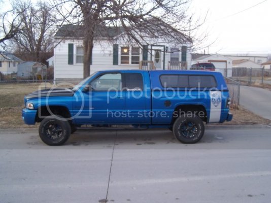

I am running 295/60/20s (34.6") only rub at full lock. I have a 2.5" leveling kit.
This is with my 285/70/17s and the leveling kit

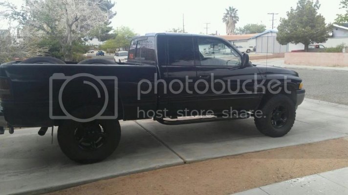

This is my truck on 285/70/17's with no leveling kit. Kida hard to see but this kinda shows what room i have with the 285's

Davy120
Jul 27, 2012
1,114
183
fairchild afb
2003
That looks like my old truck lol

Davy120

These are 315/70r17 I think you could fit them honestly
A modder is never truly done, he is mearly delayed!
Do you have a leveling kit on the truck? or does it just look like the back is higher?

No leveling kit, the driveway is kinda angled downwards. It had about 1.5- 2 inches of rake.
