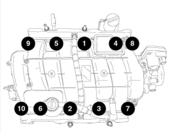

I'm curious if there is a sequence for tightening the manifold.

Always start in the middle and work your way out in a circular pattern. This helps ensure you apply an even clamping force to the intake and head surface.
