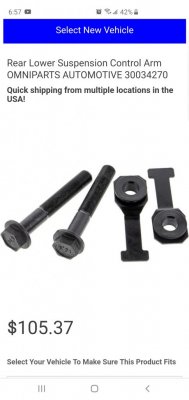

Idk how the heck it fell off but dealer voided warranty due to adding air suspension by Airlift(very stupid reason to void) and now they wont cover it . It's the nut that holds the lower control arm. I saw them listed for 100 for both the nut and bolt but was wondering if I can purchase the nut individually. It's part # 17 on the diagram.
The lower control arm part is 4877152AB
My truck is a 2018 ram 2500 tradesman 6.7L Crew cab.

Take the Bolt to a hardware store? That extension on the bolt is prolly a “ Lock” but you can just use lock tight if you want. Should save you 100$ in total.
I thought about doing that but I'm going to remove the air bags so they dont blame them in the future. Rather have it look legit as possible. That 100 dollar part isnt OEM. I think they just raise the price like crazy

#17 in your picture for a 2018 Tradesman 6.7 might be part# 6511064AA from any RAM dealer and has a list price of $12.10 if you're looking for the OEM nut. If you want it all to match just buy the bolt also if it's different from the one you currently have to match the new nut.
Double check your application at a dealer parts counter for your exact part as I'm just going by the info you posted and they will need your vin# to verify.
