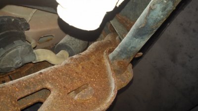

Ok...have pictures of the part. I think I know how to remove it, but I'd still like to know what it is. I also figured out it does rotate slightly when you move the lower control arm up or down. Wondering if I even need these. Once I get them out, I have a feeling it's going to be rusted frozen at both ends. I plan on replacing the control arms and if I can do without them I'd rather not deal with trying to unfreeze. Feedback/thoughts are welcome-----please....!

Perhaps it actually is a torsion bar? hmmm....

4WD torsion bar is what you are talking about and is in the pics. They are required and can't be eliminated as far as I know.

Yup thats a torsion bar.

Thank you everyone. I found it completely impossible to get these torsion bars unfrozen, even after soaking in PB and blasting with my torch. After too many hours of frustration, I cut the damn things in half and continued to hammer the sh*t out of them until they freed from the LCA's. I had to drop $170 on a replacement pair from mopar, but screw it, at least I can move forward now.

I wouldn't call troll so easily. The pics showed the rust was pretty bad so it isn't surprising with what he ended up having to do to get them out. Hopefully all goes back together without issues.

Not a troll. I had already removed all the tension, the problem I faced was that the bar slides into the control arm at least an inch, and another 1/2 inch on the key, with both ends frozen. I released the tension and dropped the key as much as it would go, but it wouldn't clear the cross member. I had very little wiggle room to hammer on the torsion bar, and believe me, I tried. Hammered it side to side, but such little play that it wouldn't budge. I then tried to drop the bushing on the cross member but that bolt was frozen in place. Another hour of PB and hammering.... I had the 3rd option of dropping the entire cross member, but I elected not to. In retrospect, I probably should have as that may have given me the side-to-side, up-and-down play and may have saved me $. In any case, I was super frustrated after several pain filled hours and I cut the torsion bar with 4 1/2 metal cutting disk. Once I had the two pieces hanging, I was able to bang and move the bar with enough play so as to free it from the arm. I had to put the other end of the bar in the vice to smash the key off. I didn't cut the 2nd one yet, as I haven't even been to that side of the truck. If it comes out I'll save 1/2 my money, but I ordered both just in case. I can always return the 2nd.
