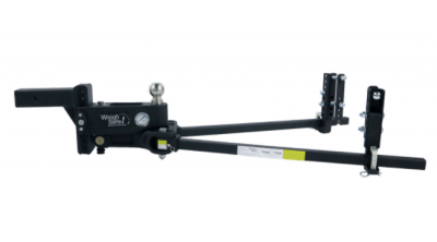

If you're going to tow a travel trailer you're definitely going to need a Weight Distribution Hitch (WDH) with sway control.
This is the best one I've found. It lets you dial in the tongue weight (within limitations of course) which is very important. No other WDH can do this, setting them up is hit or miss.
You can purchase the hitch here.
There are less expensive WDHs but this one has the best features. The only one that's better is the Hensley but that's overkill at around $3200.
Yes, these hitches are very expensive but a WDH is essentially required for towing a travel trailer if you want the best and safest towing. If you don't want to spend this kind of money you can still get a WDH for as little as $170.
