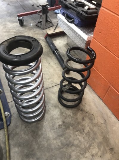

Raise the front-end and if you do, do it right with springs. Don't go the block route.
