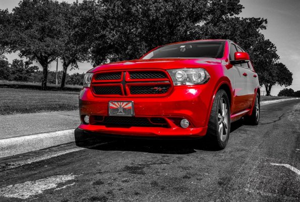

I’m trying to convince the boss to dump her 2.0t Terrain Denali for a R/T Durango…or a 392
We had a 2013 Durango R/T and it was a great traveling machine... not perfect, but still an excellent vehicle.

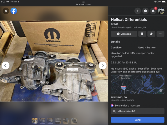

Unfortunately it’s the 2.62 open one. I’ve already started shopping for a 3.09 LSD but the prices on those seem to have exploded too!
It'll get wicked highway milege with those gears,as it'll be just over idle ,lol. Go onto a few of the Charger and Challenger pages on facebook,as you'll find the odd 3.09 diff for sale,but as you stated,most guys know what they have,and they aren't exactly giving them away.After 2019 you can get away with wiring the active exhaust open with-out a check engine light, if you want a bit more noise
Jan 17, 2016
23,817
54,824
14 Sport
Pretty well all Scatpacks after 2015 came through with the same 3.09 diffs as the Hellcats have.The 1320's and the wide body Scat's after 2019 usually also have the 41 spline axle shafts,so you might have to swap axle shafts to make the swap
