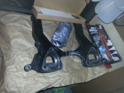

Just purchased a set of 4.5" spindles and 2" blocks. Hoping to install tomorrow. Pretty sure I have everything I could need but figured id drop in and introduce myself and post some before pics before I get started.
