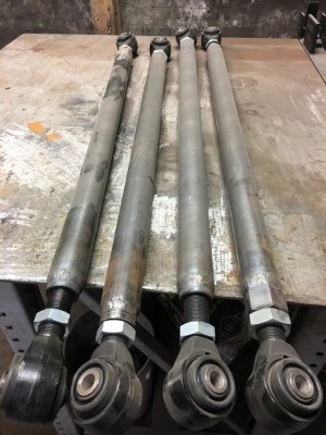

With a 6”+ lift kit, adj rear arms are needed to “Re-Center” the rear wheels from the increased lift. Also pro comp rear control arm drop brackets are needed to keep factory driveline angles.
I made 2” OD .250 Wall DOM tube control arms. Both ends use SPC sealed adj joints and have a hex head machinedinto the tube adaptor. Fully Tig welded.
These are the only arms that are adjustable while mounted on the vehicle.
