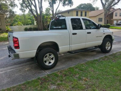

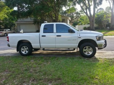

YAY! Got the spindles on, wow what a pain. Got tons of air into my brake system though so i'm going to take it to get bled.
Can anybody post a few shots showing their brake line routing, I feel there is way to much slack and too high a possibility of a kink or pinch.
This is just the front, didnt put the blocks in the back yet because I was too fustrated to do any more today.
Update: The back is in now too. Looks good! Love the kit, except for the geometry of the spindles where they connect to the upper C-Arm, The way they are made makes it insainly difficult to work on that upper balljoint bolt and impossible to get an impact wrench in there, I see no reason they couldn't have followed suit with the OEM arm how the bolt is located in front of the spindle arm making it easily accessible, doing so wouldn't have changed anything with the steering geometry.
