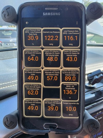

I have been watching the Clutch values in my 68RFE and i think ill be needing a rebuild in the next couple years. I have been looking at Inglewood Transmissions. They seem to be the Best our there.
What program is that?
How many miles on the tranny? How much and often do you tow?

I think i used AlphaOBD. I have 56k miles, But im lifted, on 35" tires (not regeared) and i tow 10k lbs travel trailer at least 4-5 trips a year.
