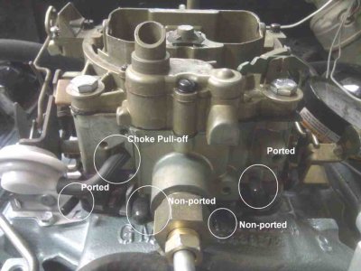

Is this what the front of the carb looks like? If so these are your vacuum ports.

No. It is an after market carb. An edlebroc or carter I belive. I will try to take a picture of it tomorrow.
