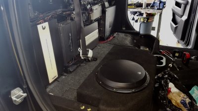

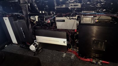

Just finished what I think is my final amp setup (yeah, I say that every time).
Swapped out a pair of TRU Technology amps for another Sinfoni and one of my bucket list amps, a Brax MX2. At this point there is zero space left for anything else. LOL
You can also get a good look at the Net Audio Single Tall Box with a JL 12W6V3.

Thanks. I'm running a three way front, plus rears, and sub, all active.
Four channel Sinfoni split between tweeters and rear doors.
Four channel Sinfoni bridged to midranges in the dash.
Two channel Brax to midbasses in the front doors.
Zapco to the sub.

Looks like you covered the vents on the bavk wall. I would imagine moisture will now get all over the amps in front of teh vents.

No, the vents are not covered. Learned that lesson 20 years and three trucks ago.

The TRU and Sinfoni are both 4 channel amps running bridged. On paper, 300 vs 360 watts to each E430. I ran across the Sinfoni used and grabbed it because it matches one I already had.
Originally I was only going to swap in the Brax but then thought I might have better luck selling the two TRUs as a pair since they are both Stage 4 builds. Need to do some more tuning to see if I’m just imagining things again. LOL
