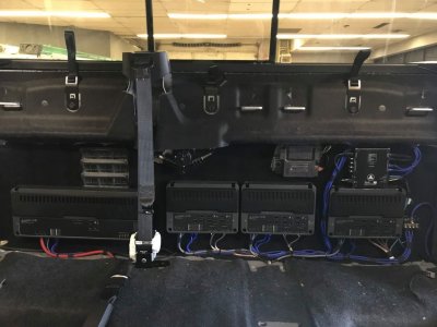

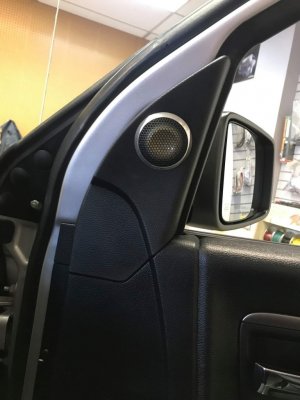

Short and sweet; here are the specs:
- PAC Amp Pro
- Toslink adapter and cable
- JL Audio TWK D88
- 3 x JL RD 400/4
- 1 x JL RD 1500/1
- 2 x JL 12w6 v3
- Fox Acoustics dual vented box
- Focal K2 ES 165 KX3 3 way front stage
- Focal K2 EC 165 K 2 way coax rears
- sound dampened doors
I’m coming from a single 12w6 in a net Audio sealed, JL C2 3.5” fronts and 6x9s in all 4 doors....untuned. While that was a superior system to the stock alpine setup, this new layout is a step above to say the least.
I’m very impressed. My tuner did 2 custom tunes on the TWK. One tune is optimized for the driver and the other is a “whole vehicle” focused tune which brings the rears much more into play. The only reason I went so beefy on the rears was to have decent sound for the kids When they are back there. We summed the channels in mono for the rear 2 speakers to make the TWK work with just 8 channels. Both tunes flat out perform and I’m very happy with this upgrade.
Any questions just let me know!

Looks good! Nice and neat on the install. What type of headunit are you running with all this? Sorry if I missed it somewhere.
Saskwatch
Saskwatch
Sep 17, 2018
148
89
Saskatchewan
It’s still the factory Alpine 8.4 setup. It’s very unlikely I’ll be making any additional changes, especially to the head unit. You’ll likely see me in a 2021 rebel before this truck ever sees another stereo upgrade lol

How does this sound??? Is there enough space to get low?? Is this the ported 12 box or sealed?
Saskwatch
Saskwatch
Sep 17, 2018
148
89
Saskatchewan
I think the entire system sounds great. Specifically relating to the 12” subwoofers, these are in the vented (ported) version of the fox box. This setup goes every bit as low as the previous single 12” sealed (12w6 in net audio tall box) but with more ease and authority. I guess it depends how low you want to go. We’ve got the DSP to cut frequency at 20hz but I don’t think this box could handle that low since it’s a pre-fab ported. Generally speaking, id wager a strong bet that dual 12w6 in a net audio sealed box would dig a little lower than this setup, but I’m not a scientist nor am I going to conduct the testing lol.

How did you mounts the amps to the black wall? plastic? mdf? glue?
jackal98
Aug 10, 2015
94
32
Hemi. 5.7
A lot of people use extra strength Velcro on the back of amps.
I used a pegboard from Home Deport & zip tied the apps & wires neatly.
The last step was to zip tie the pegboard to the black wall.
Saskwatch
Saskwatch
Sep 17, 2018
148
89
Saskatchewan
The amp rack is wood that has been attached to the back wall using an adhesive. The wood has been carpeted and then the amps were screwed in place.

I’ve had some questions about electrical upgrades, or lack there of on this setup.
This system is ran 100% on the stock electrical right down to the battery.
The RD 1500/1 has its own 0 gauge amp kit and the three (3) RD 400/4 are ran from a 4 gauge kit with a distribution block.
