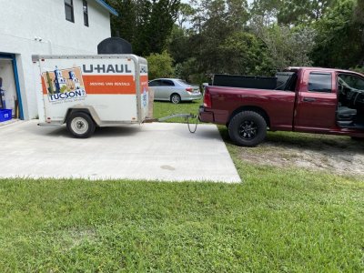

I just moved recently and had a fridge in the bed and towing uhaul 5x8 enclosed trailer running the eibach springs in my truck. Truck handled well. Not near 4,000lbs but better than I expected. Had a full bedroom set, clothes, other bedroom items, and whatever else I could fit. Truck was squated almost 2”. My truck sits lifted 3/1 with 35s. Nick is great and can answer whatever questions you may have. He helped my buy my parts. Although there are tuftruck coils that are designed for heavier loads all the time as well for doing just the rear and just run adjustable struts up front for leveling. Could also add airbags if that suits your needs better.
