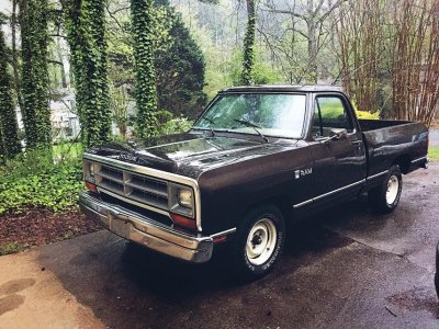

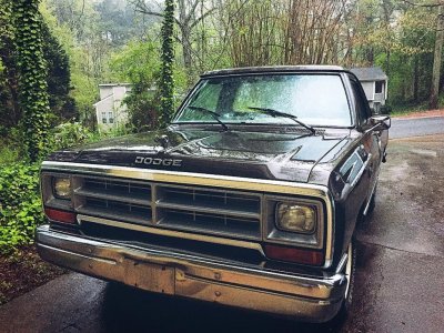

I came across a great deal on a 1989 dodge d100 and had to to grab it. This is my first truck so new to dodge truck but have experience on other cars complete home mechanic not a professional, but after having it for a week really not much needs to be done just trying to figure out what exactly i have for future references.
So the car is short bed with power steering and brakes no a/c 3.9L v6 so the 293 if im correct, the tag under the hood is really faded but i was able to read the trans tag it said a998/a999 so i am confused on if its the 998 trans or 999 the truck is not 4x4

Congrats on your new to you truck :) Pics needed or it never happened lol Good luck with the truck

Very nice looking truck! I can see why you got it :)

looks really clean!
didn't know dodge was still doing the d100 vs d150 into the late 80's. If the did stick with the original reasoning behind those numbers, your 100 will have lighter duty axles vs the 150. don't know if the emissions were any different by 89 though.
daily driver or any plans with it?

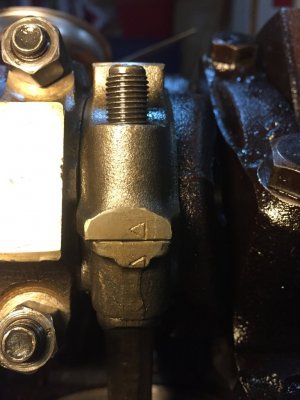

ended up getting a 5.2 out of a 98 durango and rebuilding it i'm in the process of putting it back together just ran into a problem I kept the rod caps and with the correct connecting rod but i didn't pay attention to direction the cap goes on and after getting the caps only torque to 20lbs i can't turn the crankshaft.
how can i tell which direction the cap goes on

just noticed these symbols on the caps and rods are they suppose to match up with each other

reek

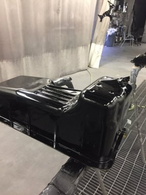

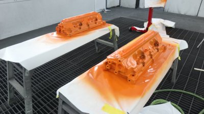

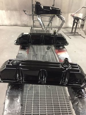

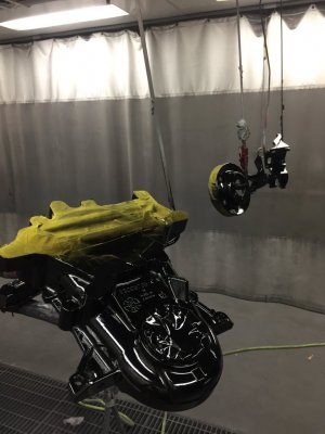

appreciate that it just a going to be a stock rebuilt 5.2 magnum with some headers but i still wanted it to look nice painted some other parts as well
