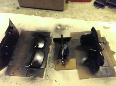

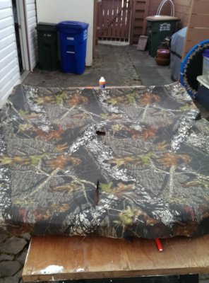

hey guys, exactly what it says, took my headliner off so i can do smoked cab lights but i also decided to do my headliner in matching camo (outside of truck) Mossy Oak Break Up, easy enough to pop everything off, lay the 2 yards of fabric over the headliner and glue then trim some, its sitting now til tomoorw where i will fix any spots that need extra adhesive (i used an old can of elmers adhesive spray my Grandmother had) and i spray painted my parts for the headliner black with a flat black then a black lacquer. looks sweet so far cant wait to see it tomorrow

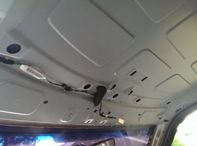

Forgot to post mine as well, so you know how it looks:
Before:
After:

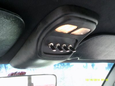

And about 2 weeks ago built a switch panel for my offroad lights, so painted the console and visors to match (the visors were the vinyl type ones, not cloth)
Make sure to use paint designated for plastic / vinyl, and clean it beforehand. And only reason why overhead console looks splotchy is because I had a tiny bit of residue from Di-electric grease from those switches. (Picture was taken immediately after install)
