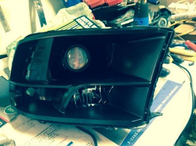

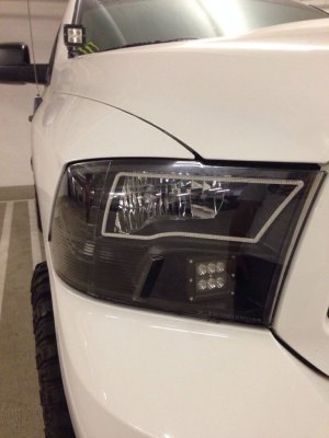

How did you make those, I want a set so bad
I painted the headlight housing and took apart the led pod to paint the reflector face black to make it stealth but not loose any light functionality.
