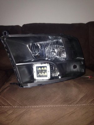

Cool! Be warned, people who do this mod on street trucks have reported the headlight inards not being able to handle the weight of the Dually and cracking / failing.
I noticed that the dually pod is pretty heavy compared to the headlight plastic. I'm going to try and figure out a way to cement it in there enough so that the weight is somewhat evenly displaced. Any recommendations ?
evanblain
Nov 5, 2013
394
90
Alberta, Canada
What about something underneath? Like add some kind of support underneath the bezel.
