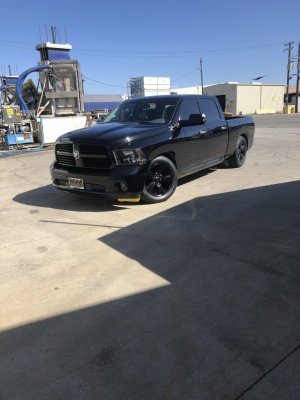

IMG_1429.jpg Sounds like you need a pedal commander or a pulsar.
Woke up my hemi after installing both. Mpg around town is 12.2 and thats probably because i can't keep my foot off the gas pedal. really happy with that.
