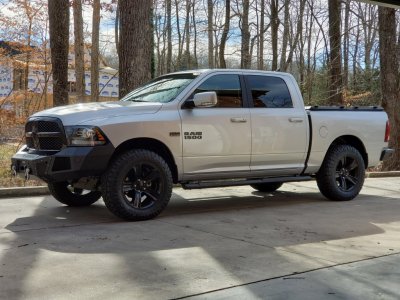

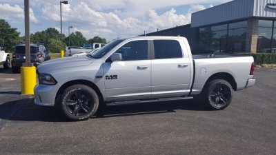

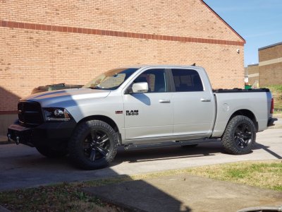

After having a blowout on the crappy stock Goodyear Wrangler SR-A tires, I decided to go with the Nitto Ridge Grappler tires in size 285/65R20 (35x11.5), and I think they look great. I do have a slight rub on the inside of the front Go-Rhino bumper when turning at a certain angle, but I will be installing 2" spacers on the front as a temporary fix until I get a proper lift. I was concerned about the weight of these tires compared to the stock tires (64 lbs vs 40 lbs), but fuel mileage has not suffered too much. Here's a stock picture and a picture how she currently looks.
