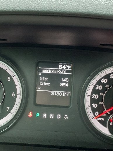

yeah, previous owner put 26K on it in only 18 physical months of ownership... (I forgot to record the driving hours when I got it... stupid ass me) now he and I are in STL MO and how he put 26k on it I'm not sure...
