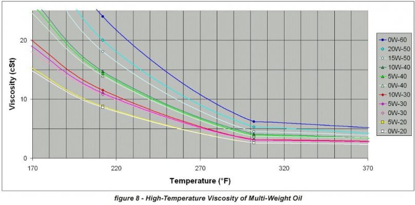

0w20 and 5w20 are almost identical, but yeah they are both thin. The bad news is coming though, it is a matter of time before they will put in 0w16 and that is 2 full points thinner. See the bottom two lines 0w20 and 5w20 white and yellow, they will likely operate the same at temp.
Depending on the formula, in many cases 0w20 can even be a better quality oil. if they use pao to achieve cold flow instead of vii's.

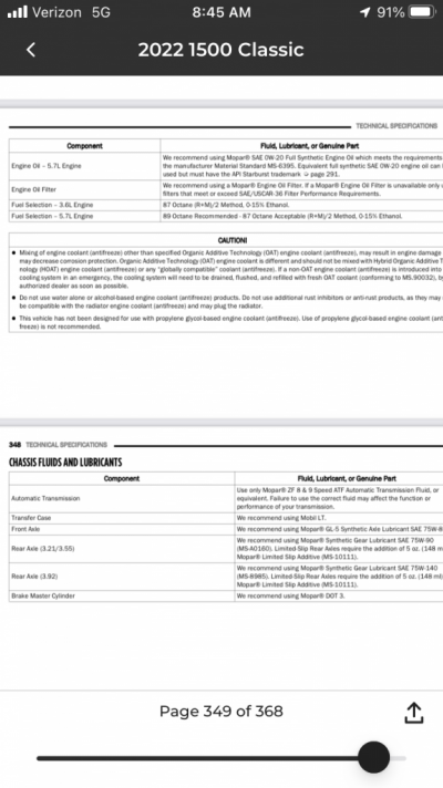

From my 2022 1500 classic owners manual
5.7L engine-0w20
3.6L engine-5w20
My wife’s rav 4 takes 0w16 I believe

Like @Burla said, there's essentially no difference between 5w20 and 0w20. The 0w will pump a hair easier in extreme cold is about it.
