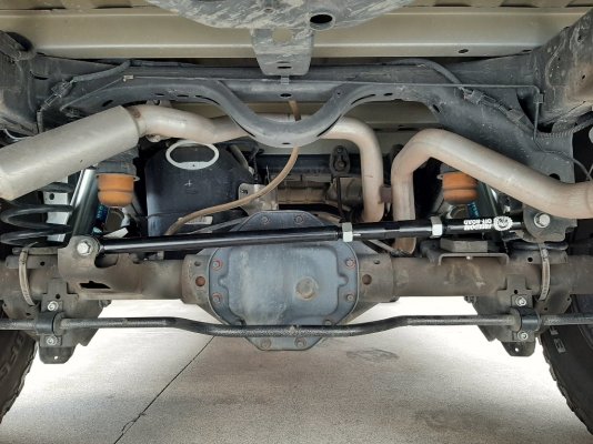

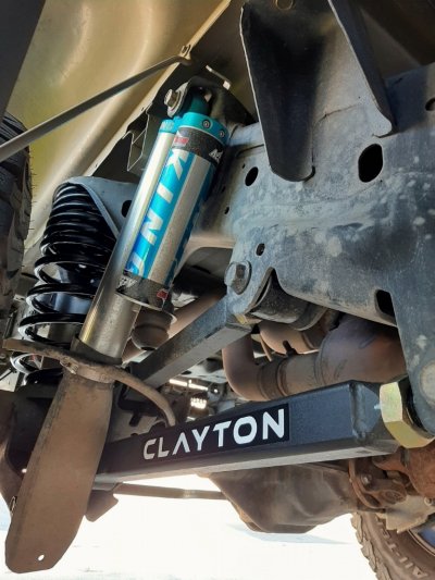

I've had arms from Synergy and Metalcloak that use similar bushings I've had zero issues with their DDB's. they're fully sealed.
Few years ago I asked Synergy about their DDB bushings.
This is what they wrote back:
"Imagine an oem clevite, without the disadvantages. They absorb high frequency road vibrations, which heims don't. They don't dry rot because they aren't rubber. They don't tear under articulation like a rubber clevite will. You don't have to tighten them at ride height because the inner sleeve spins. They don't need grease. They don't gape when they articulate so last longer and stay quiet by not allowing crap on the bearing surface.."
I was sold in this type of bushings years ago and Ive continued to have them throughout the years. they get done the job done in any type of weather and road /climate conditions and you don't have to do a peep like the stockers.The bushings on both ends can be replaced, or you can upgrade the rod end with a JJ.
The Core setup will be sweet as well, i wanted to do those with JJ's on both ends. decided on these ones to be different, and to show we have a lot more options out there as well when it comes to rear control arms., same for the rear trackbars.
https://www.ramforum.com/threads/4th-gen-1500-coilovers-struts-shocks-control-arms-trackbars.158811/
I'm sure Metalcloack and Synergy will soon offer a rear setup for the JT which will add 2 more options for the RAM. Win-win.
Hope it helps.

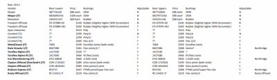

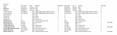

Sorry yep, i have them in my list. If you click on the link from post#24, and click on 4thg_Gen_rear arms.pdf you'll see everything we have available so far in that regards. i update those files as i know there is something out there that can fit. I have coil springs in there, struts, coilovers, rear shocks, rear trackbars etc.
So for rear control arms

missing Rusty's...
https://www.rustysoffroad.com/jeep-...-upper-control-arms-w-forged-flex-end-jt.html
and Skyjacker...
https://www.extremeterrain.com/skyj...-upper-control-arms-for-3-in-lift-gulr24.html
probably more.... not attempting a ******* match by any means so please don't take it that way, just saying basically every major "JEEP" brand has something to offer now.
No no please. Keep them coming. This is the idea behind keeping that list and promoting sharing more of the aftermarket parts we may have available with our RAM community. i didn't know Rusty had JT arms, i just bought some pieces from them for my 01 WJ last week, it didn't occur to me they had those available. Same with Skyjacker. I'll add them to the list next.
Thanks so much for sharing.
Edited: The Skyjackers you listed are fixed length, but they're listed for 3" lift JT's. I don't think that will translate to 3" in the RAM so i won't be showing that one in our list.
I found the adjustable ones on the same extremeterrain site, both upper and lowers that are not lift specific, but i can't find info on the bushings. Extreme Terrin says poly yet the pic show a JJ in one side. Skyjacker doesn't list them by part number.., Weird, but Extremeterrain or SummitRacing do. Summit says bushings are rubber. Given we don't have enough data to make the determination I'll wait for this info to be updated, in the meantime i won't be listing these ones yet but i'll keep on eye on them.
