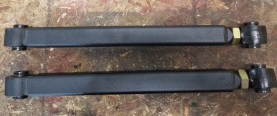

49664539047_be3b9c9bfc_k.jpg2020-03-15_06-17-09 by RAM RSM, on Flickr
Which of these rear control arms have you actually driven with for a period of time? I’m trying to figure out whether to go with Core, Patriot, or Clayton rear control arms for my lifted 1500. Apparently Rough Country keeps the stock rear control arms for their lifts.

Stockers for almost 2 years and my truck had already around 50k miles when in bought it. Mevotech Supreme which are basically stock replacements for a few months, same with Freedom Offroad stock lenght and now the Claytons set at stock length. You won't go wrong with either choice main difference will be in the bushings and how beefy the arms are if you need such a things so it depends on what you're trying to accomplish. Now that i've been driving with bushings that can flex side to side is that i can appreciate having them as the suspension flexes as it should when it needs and if i need to put the full weight of the truck in the lower control arms i have piece of mind the massive Claytons will take it without a sweat.
Most of the aftermaket like Core, Clayton and the like are built tough so you can have confidence you're paying more for beefier arms and better than stock bushings.
If you have a truck setup for the street Freedom will do well,
If you're into offroad Core and Clayton have better bushings for that mission. Core uses a JJ in one side and some sort of flexy poly bushing on the other, though i'd recommend if you go with Core to get JJ on both sides for the ultimate in strength.
Clayton have Giiro bushings on both sides, or JJ in one side and Giiro in the other and if you ask i'd guess they can put JJ's on both sides. I went with Clayton because i wanted the benefits from their Giiro bushings. i'm more into overlanding so i wanted longevity and maintenace free like the stockers so things like mud, dirt,snow won't contaminate the assembly. Eventually the bushings need to be replaced but i had 50k miles of trouble free miles in my Jeep equipped with Synergy arms with DDB's and before i sold it i was a happy camper , i'm expecting the same from this Giiro bushings, big plus since my rear is loaded with 500lbs at all times and when i go to the desert and beat the crap out of the truck i like the confidence in torquing down rear control arms bolts at the 200lbs factory specs.
If you go with JJ's they have proven to flex well, and they can withstand a lot of offroad abuse. Cool thing about JJ's is that they can be rebuilt/serviced when needed, sometimes than can be a little often depending on the conditions they have live in so greasing those zerks is really important for longevity.
With Giiro bushings you have to press a new one when needed. Both are cheap, Giiros or DDB's have been around for less time but they seem to be proven themselves in the overlanding community again because of their design: free pivoting, self centering, self lubricating, zero maintnenace. etc installing a set couldn't be easier as you don't have to worry much about the angle of the head, the bushing doesn't get smushed if you torque it to King Kong specs as they're made to take the torque (In Clayton's case they're made for the Jeep JT which borrowed their control arms from our 4th gen truck so Clayton designed the bushing counting on those high torque specs in mind, JT is 190ft/lbs, RAM is 200ft/lbs).
https://www.claytonoffroad.com/news/overland-plus-days-compromise-are-over
Again, good luck with whatever you choose. i don't think you can go wrong with either choice. Anything is better than stock, but stockers are not a bad option if you just need a truck to do work as the factory intended for example. If you're looking into offroad, overlanding, 1/4 mile racing, or just want the look of beefier arms the aftermarket has specific choices to meet those demands.
Have fun.

You're a book of knowledge! Thank you.
I read the whole post. Seeing all the options now available. Is Clayton still your choice to buy?

I got the Clayton Overland upper and lower set and I can definitely feel the difference when I hit the gas. It’s definitely more solid and no more wheel hop either. I can feel a control difference and they’re double the size of the stock arms. It was a great purchase for sure.

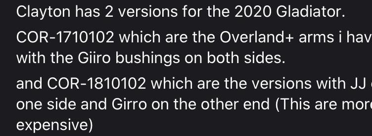

where are you guys ordering these from. when i go to there sit. it only list jeeps no rams?

That's correct. They're not RAM specifics per se. We're benefiting from the 2020 Jeep Gladiator aftermarket since Jeep borrowed the rear control arms and rear panhard from our 4th gen RAM's and fitted the Gladiators with those so Clayton and other big names in the Jeep aftermarket have taken the stock arms design and have made awesome more sturdier replacements. Win win for the 4th gen RAM 1500 community. If the 5th gen uses the same rear arms we do, then they can also join the party :)

I get it now. probleby not a good idea for me than. since i have a 2500. I have been looking at core.
I just got the lowers, on a budget. But, I hope the wheel hop goes away.

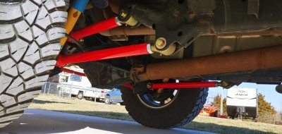

Claytons in the house!
Question? Does the rear get jacked off the ground, or not needed?
$290 shipped if you are a FR or Military. Item #COR-1710102

Leave the truck on the ground. Or at least make sure you don’t tighten them until they are. It was easy enough to do on the ground though.
Thank you Sir!
Torque specs are 200lbs?

You’re welcome. I went with 190 because that’s what they’re made for on the Jeeps that they were designed for. 10 foot lbs isn’t going to hurt them.

leave the truck on the ground. The axel might shift a bit once you take the factory arm off. You will know because one of the bolts won't line up with the hole in the arm. Super easy to fix, jack from your diff pinion just a tad and wiggle the bolt. You may need to do it couple of times until the hole lines up.
for example:
