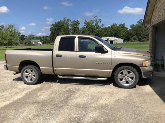

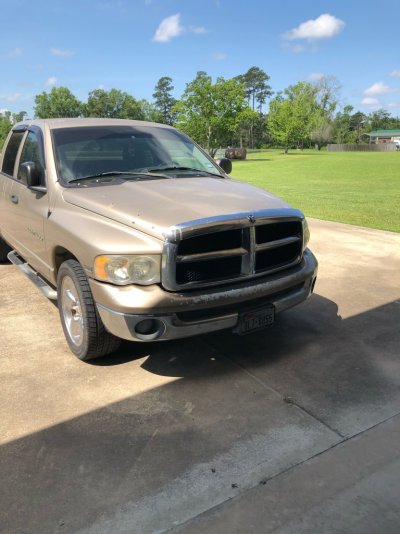

Morning all! I’m Andre from TX just received a 2003 1500 5.7 from my old man. Itching to start building my first street truck. I know nothing about dodge but am familiar with building trucks. I’m an old school ford guy. Plans for this truck are so far Comp cam, 3.93 gears and Eaton LSD, heads ? not sure what works best with these engines yet. Dual exhaust with X pipe and maybe flow master 40s just cause I like the sound of em and long tube headers. Not sure what to do to bulletproof the tranny yet. Still researching that.
Any suggestions, tweaks/adjustments and/or advice welcomed and much appreciated!IMG_1824_Original.jpeg70672209439__78CAD05B-48BA-477E-8C3E-8D89D1B9B666_Original.jpeg
