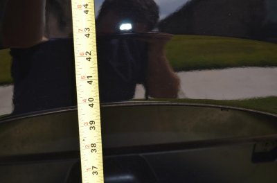

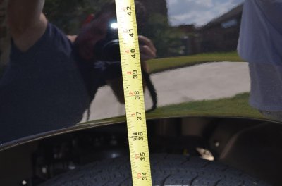

Thanks so much for all your help. I currently have a 3" rake (39.75 rear, 36.75 front). Since the RCX kit will eliminate 1" of the rake, I should set the bilsteins to 2.0 to eliminate the rake completely, correct?
As long as the 6" RCX kit along with the bilsteins will be tall enough for the 37" tires and not look too stuffed, I will just go that route and forego the coil spacer.
I plan on getting this done in short order and will post up pics when its done.
I honestly would set the Bilsteins to 1.4 if you are not putting a rear coil spacer. You may potentially have a squat setting it to 2.1
Or, set it to 2.1 and if you have a slight squat and are ok with it, then leave it.
Its easier to throw a coil spacer in then re adjust your Bilsteins.
