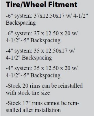

I guess the thing i worried the most about is If i can use my stock sport wheels without spacers. I'm concerned if they will clear the aftermarket knuckles that come with the kit and I figured someone on here has run the same lift as me with stock wheels.

Yes the stock 20" sport wheels will fit just fine, its the tires width that sometimes rubs when you install a 12.50 wide tire on the stock wheels.
