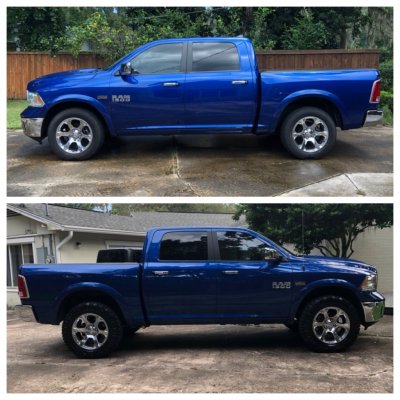

AA41643D-37DD-497F-9E28-DEEE456CEAF4.jpeg Ok, here’s a before and after pic. Sorry it isn’t in the exact same spot or orientation.
Before fender height was Front-36.5”, Rear-39”
After fender height is Front-39.5”, Rear is 41.5”
I can’t wait to clean off the tire shine goop the shop put on. Also can’t wait to get up to speed on the sandy forest roads. It should be fun.

View attachment 176649 Ok, here’s a before and after pic. Sorry it isn’t in the exact same spot or orientation.
That looks great. I'm sure you'll be able to tackle those roads easily now. .75" height gain with the tires, right? So, 2.25" lift from the front 2.0s and 1.75" lift from the rear Icon springs? I bet those will eventually settle a little bit down closer to their advertised 2" & 1.5" lift. That blue Core4x4 stuff does look awesome, nice work all around.
Yes, overall, 3” in the front and 2” in the back. Nitto says the tires measure 34.7” tall. I’ll try to measure them tomorrow and verify. And yes, I think it will all settle down to the advertised height in a few weeks.
