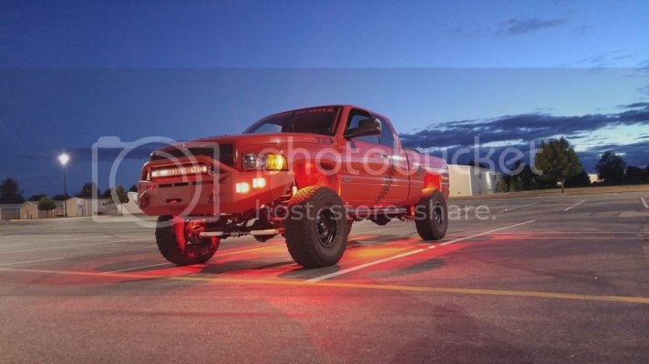

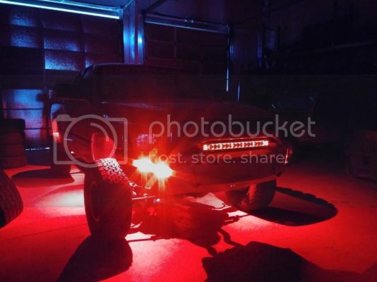

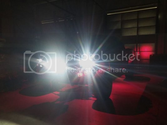

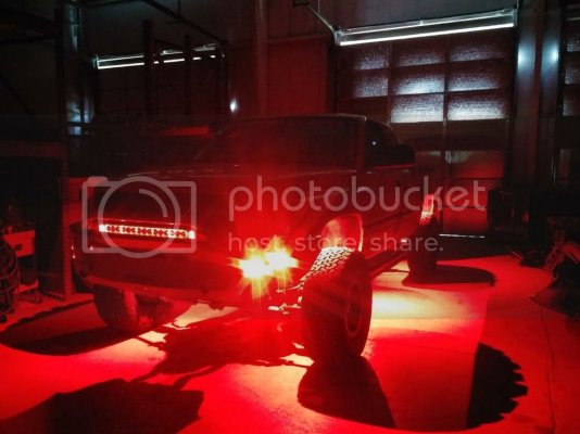

I don’t actually have a night shot with ALL the lights on, but I have a few pics with some of the lights on. I’ll try to grab some here in the near future with everything lit up at night, problem is it’s daylight at 6am here and isn’t dark until almost 10, and by then I’m usually getting ready for bed. I’ll post what I have at the bottom of this.

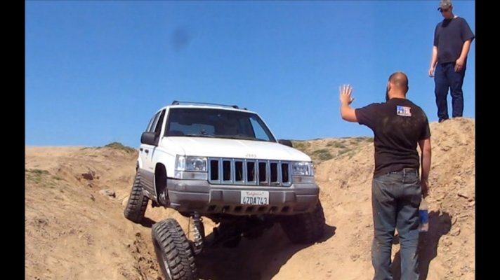

Currently the truck has more articulation than a competing local off road shop and their built TJ on 37’s, which on their RTI ramp got up to 34” before it picked up the back tire. Of course wheelbase wise it still has a better advantage over mine, but I’d say for a full size Dodge I’m doing pretty damn good.

Pretty crazy how much travel it has. I like all the red lights! That truck tent sounds so much easier than a regular tent if it is that fast. Keep the updates coming man. I like how much detail each of your posts have. Don't forget about the flex thread either!!

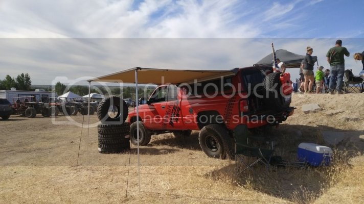

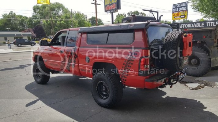

Alright so I kinda jumped the gun and pulled the trigger on an awning. Reason being, I have the X Rocks event this weekend, and while prepping and packing yesterday I discovered we somehow lost our pop ups.
So rather than rush to the store to buy one, I decided to order in what was available to get overnight, which is the ARB 2000m awning. I also ordered the touring room with floor and roof, but that won't be here till next week, which I won't need this weekend anyways.
So last night I snatched up my camper shell, then today got the truck washed and detailed, then around 3:00 went to the shop and threw the awning on.
I'll still be doing the Tepui Tent on the top, but for now I'll skip out on their awning with the separate room and mosquito room. Not to mention this setup this whole setup cost me less than $500 for everything, so there's that.
No pics of it setup yet, just installed then rushed back to the store to get loaded up. Also, for one of the first times, I think the camper shell looks *******. Mostly due to the TireGate, but it looks a whole hell of a lot better than it did before.

At this time no. With the TireGate open I can reach in and touch unlock the adventure box in the front of the bed, I do have to climb in to access it once it's opened but that's not a big deal. I also have the swing case that is mounted right behind the drivers wheel well that holds a lot of smaller stuff, so cargo wise I have plenty of storage for my needs in the bed of the truck.

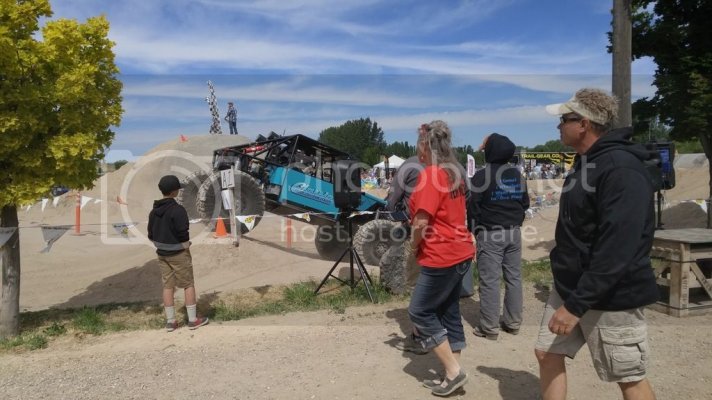

Update for the awning. Wicked. First time setting up took me less than a couple minutes to do, and that's without instructions. Very sturdy for an awning, other people at the events were having to hold or tie their pop up's down with additional rope, mine I left unattended a couple times throughout each day and it never once had an issue with just the pair of ropes it came with. Can't wait to get the touring room, which should be here Thursday.

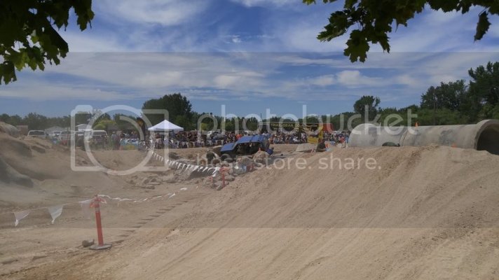

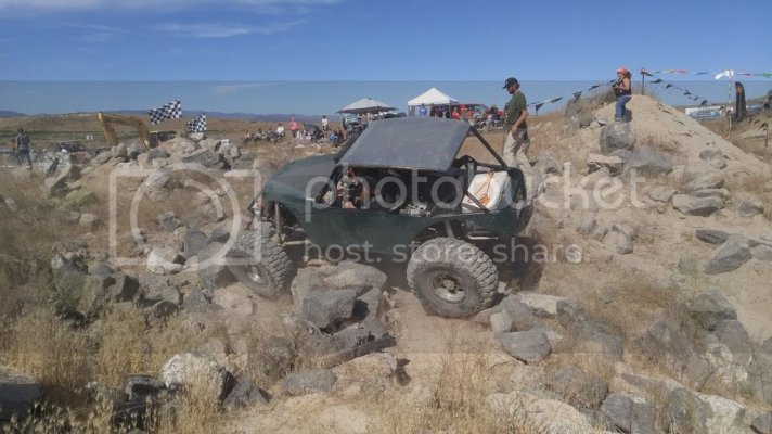

The show went well, truck got a ton of attention. Finally met quite a few of the people planning this Rubicon trip with me for the first time over the weekend from the clubs I posted in. Also enjoyed the show as well.

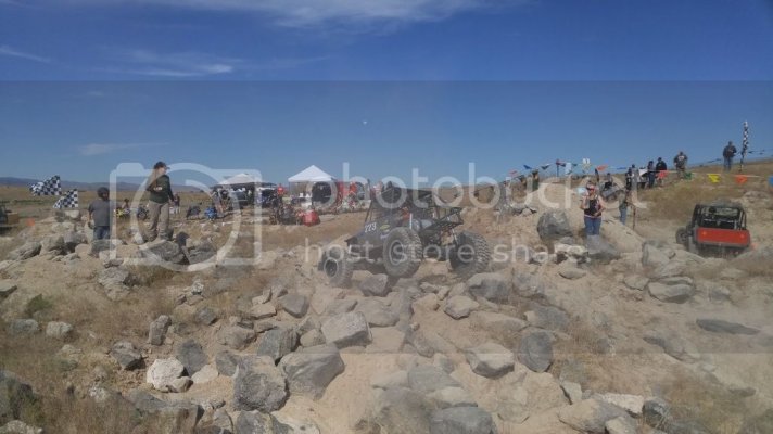

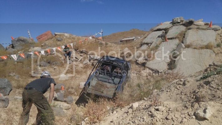

There were a ton of recoveries over the weekend. Being alone at my booth I had a hard time getting away to watch the event, let alone take pics or videos. I got one video of a dude I give mad credit for. Lost a cylinder on his crawler at an event a few weeks ago, couldn't finish the third course, so he goosed it hard up the tabletop and flipped it backwards just to put on a show for the spectators.
Last year he did the same thing, only it was not intentional and it was insane to see.

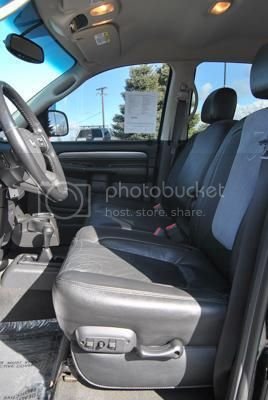

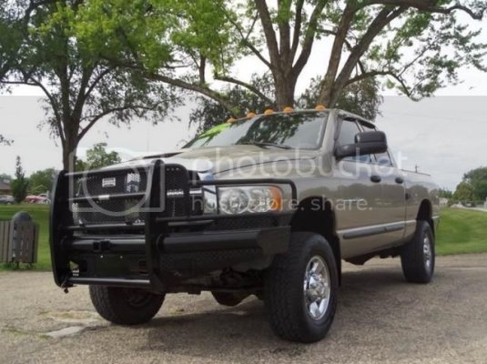

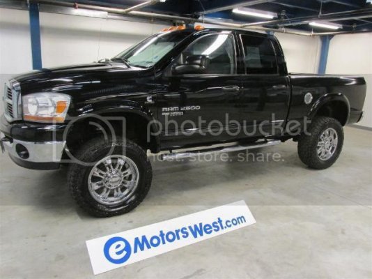

1st truck: 2005 Ram 2500 Power Wagon - This is the main truck I'm looking at. I went and test drove it in Mountain Home this morning, and it's ideally what I'm looking for. With this truck, I can essentially do almost anything my current truck can do, and I can focus on building my 01 into something a little more. But the Power Wagon I'd be able to take anywhere, the 5.7 will be capable of pulling what I need it to, and it's already got some basics on it I would want to do, which would be gears and lockes. Also, the leather would make it easier to clean up after the kids with, as I’m finding out the hard way in my 01 that crayons and chocolate is a major pain in the ass to try to get out. If this is the truck I pick up, I’ll keep it somewhat basic. Leveling kit, 20’s and 35’s, and Fusion front and rear bumpers. With the new fab being 4th gen bumper swaps on 2nd and 3rd gen Rams, I’m thinking I’ll have Fusion incorporate in the 4th gen fog lights instead of doing the dually’s like my 01 has. I’ll also have them eliminate the winch plate, but put the fairlead hole and keep the winch in the factory location and run it out the front bumper. Maybe get into a custom headlight build, led tail lights, and then just call it good.
2nd truck: 2006 Ram 2500 – This is the 2nd truck in the running, and my 2nd favorite choice. The wheels will go quick, but it’s the 5.9 Cummins and it’ll be a truck that can pull whatever I want, so I’ll never be limited by what I need to haul. Plus the only thing right now I have I need to pull is my 01, which the diesel will be ideal for. The only downside is I won’t be hauling my 01 very often, and I don’t intend on getting anything large to pull in the nearish future, so a diesel truck really is overkill for my needs, plus the cloth will require seat covers to protect from the kidlets. Not to mention I’m a bigger fan of the earlier 3rd gen headlights and interior. But a diesel would be nice to have around, although I’m not a very power hungry guy so very basic upgrades would be done to it. Overall for this truck if it were to be the one, I’d leave it with the stock bumpers and just do leveling kit, 20’s and 35’s, and the custom headlights and led tail lights.
3rd truck: 2004 Ram 2500 – This is a truck that I keep getting drawn to for some reason. I really dislike Ranch Hand bumpers, but I was driving through Nampa the other day and saw it parked at the dealership and I really had to swing in to take a look to cure my curiosity. It’s seriously like brand new, and it’s got a lot of the basics done to it that I would already want to do performance wise, leaving that not needed in the future. I’m not a big fan of the color, but like I said, for some reason I like the truck, and it’s the cheapest out of the 3 I’m looking at, by 5 grand actually. The downside I have with this truck is as stated, the color, cloth interior, and again I really don’t need a diesel. But if I wind up with, I’ll start with trying to trade the Ranch Hand for a nice looking stock bumper, then do the same wheels, tires, and lighting as the other Cummins. If I can’t trade the bumper (which I don’t foresee being an issue to be honest) I’ll probably wind up going Fusion with the 4th gen fog lights and a matching rear bumper.

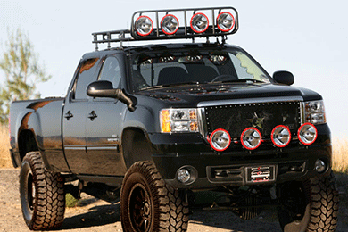

Another fun update inspired by Derek and his truck, I decided recently what roof rack I’m going to use now that I’ve dropped the frontrunner and Tepui tent stuff. Going with that classic overland look, doing the Smittybilt Defender series on the truck. The rack will be 5 feet wide and 9 feet long, spanning across both the cab and the shell. I’ll use 6 total mounts (3 down each side) on just the shell that will bolt through. Over the cab, I’m going to use 4 (2 down each side) hydraulic bump stops that I’ll bolt to the bottom of the rack, and have it rest on the roof of the truck. With doing this it gives me two things: 1) removal of the shell will be as easy as it is now due to the fact I’ll have nothing to unbolt off the truck. The rack will just rest on the cab; and 2) flexing the truck won’t rip the mounts out, crinkle the sheetmetal on the roof, or crack the fiberglass on the shell. The hydraulic bump stops will allow the rack to flex with the bed, so there will be nothing up there “tying them together” so to say.
The rack will still be a while, as I have other stuff I’d need to acquire and build before I’m ready for it. But accessories would include:
One 50” Rigid Midnight Series across the front
Two pairs of Rigid Dually Spots with 2 facing out of each side of the rack
Two pairs of Rigid Dually Diffused with one facing out of each side, and a pair facing out the back of the rack
One pair of Rigid Dually Floods with one facing out each side of the rack
The idea if you were to look at the truck from the side and scroll front to back would be Spot, Flood, Diffused, Spot. All of these combined would give me more than enough lighting for both distance and up close.

Couple photo's of the Rack. Mine is for "motorhomes and vans" and will be full length, from the back of the shell to just before the windshield. But it gives you a good idea of what it looks like.

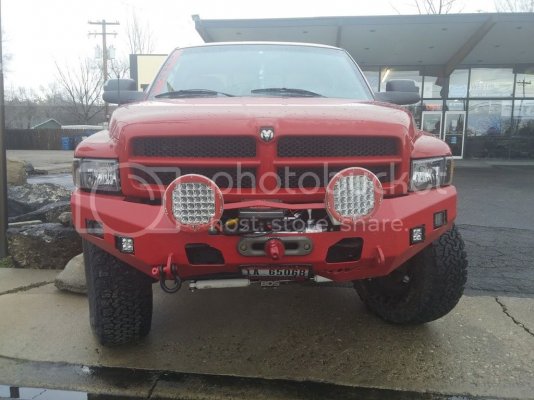

And for those who don't remember what the 9" LED's looked like before the bumper fiasco, here's a reminder.

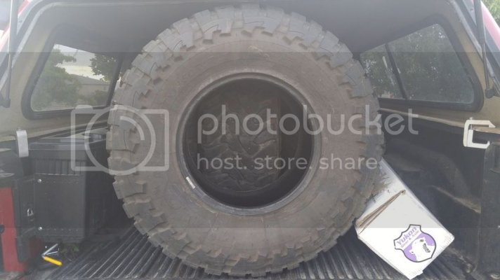

The 5th tire is obviously for the spare to go with the four tires I bought about a month ago.
At this point I’ll have everything I need to do all the suspension, steering, and be ready by next summer for some real overlanding trips minus the wheels for the tires. Without having a job in this field any longer, I’m thinking I’ll just order in some plain black 17” steel wheels, something like a 17x10 with a 4” backspace, then do the DIY beadlocks on them and have the rings powder coated red. A DIY kit runs about $400 for a set of 5, and a 17x10 steel wheel usually sells for around $120 a piece. That’s about a $1000 in beadlocks compared to ordering in the TrailReady’s like I had planned at about $528 per wheel. The only thing TrailReady I will use are their RADS, or Rapid Air Down Valve system that replace the valve stems. Basically I can air down my tires to a set pressure by twisting the valve. It’ll air down to say 10 pounds, then stop when it hits that pressure. From there just turn the valve and hit the trails. Easiest system out there, although not DOT approved, however beadlocks really aren’t either so meh.
Until I get ready to do all this suspension upgrades and stuff, I’m just going to use the truck as is and finally sit back and enjoy it. The way it sits, it’s very capable and I should focus more on using it for what I built it for rather than the “what can I do next” mindset. The only stuff I’m going to worry about getting done it quickly is the roof rack and getting the sliders built. Everything else I have coming can stock pile in a corner of my garage until I’m ready to do all the suspension work.

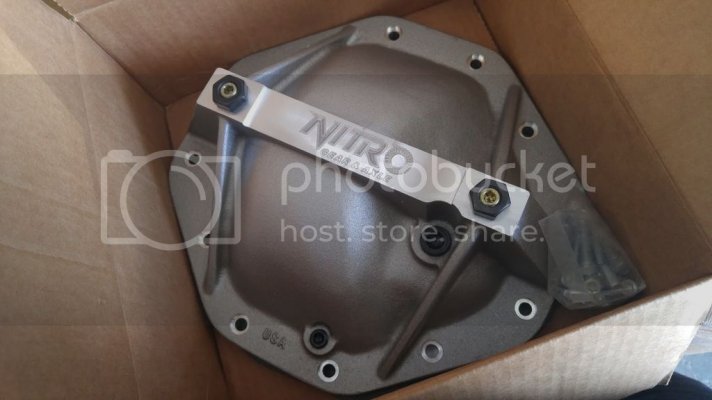

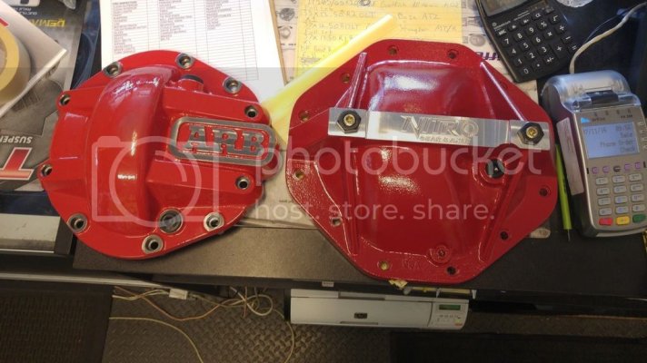

Not sure if I ever updated here about the Cranium Spider rear diff guard, but I finally told them to shove it and give me a refund. I ordered the part months ago, and every time I call for an update I was told a different story. So I’ve been trying to find something to put on the back that will be similar to the ARB, but didn’t have luck until I was talking to one of my gear reps today.
I was talking about rear covers, and somehow we got on the subject of c clip eliminators for the 9.25 and how Yukon used to have a kit, but no longer do. I was telling him that was my main concern for this truck was snapping a shaft and having my wheel walk out from under me. Then we circled back around to the diff covers, and cheap “insurance” to prevent the c-clips from breaking. Nitro Gear & Axle have what they call a Girdle cover which is aluminum like the ARB, but it’s something special as well. In the face of the cover it has two bolts that come through, both attach to some arms that line up with the bearing caps of the axle shafts coming through to the carrier. Basically you install the cover, then crank down on the bolts in the cover to apply some heavier pressure to these caps. One of the biggest causes for a c clip to snap is from the flexing of the shaft. Applying pressure to the bearings there will help prevent flexing inside the pumpkin which in theory should help keep the c-clips from snapping.
So, it’s on its way, should be here Friday. Hoping to have it painted red to match the ARB Friday night and install both covers sometime this weekend.

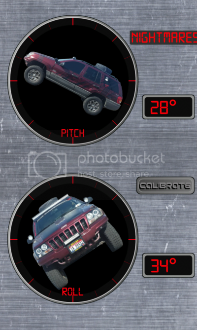

The ultra cool part I can do is download a roll/pitch inclinometer I had purchased off the app store when I still had my WJ. My CTS2 has an inclinometer on it, but I usually have that set to the toggle switch screen so I can control all my lights. The app I purchased allows you to do your own custom vehicles, which means I can use a head on view of my truck, and a full side view and actually have it showing on the screen of the stereo rather than just another cartoon vehicle or Jeep.

Got the trail rack picked up last night and installed. Pretty simple, just drilled a couple holes in the TireGate and bolted it down. Looks a lot better than I was expecting, I was a little afraid of it looking out of place but it doesn't stick up higher than the camper shell so I'm calling it good. Should look a lot better once the roof rack is installed too.
Just for *****'n'giggles because it looks badass
Also, kinda upsetting. Got my first battle scar...and I didn't even inflict it. Not sure where it even came from. But meh, I'm gonna get some more on rubicon trail so not too crazy pissed.

I received and painted that diff cover which looks pretty good, I'm excited to get them installed. Would have done them yesterday but got caught up with family functions, and Saturday the paint wasn't cured so I would have screwed it up during install. Not an exact match in color to the ARB, but once installed nobody will be looking at the both of them at the exact same time so meh.
Another fun update. I sold my five 37x12.50x17 MTR's to a local member of a club around here. In turn with the $1500 I got out of them, I bought a set of four used 37x13.50x17 Toyo MT's for $500 bucks. With the remaining thousand bucks I'm ordering in five 17x9 steel black wheels and a DIY beadlock kit. We have a half tread Mickey Thompson MTZ 37x12.50x17 that's in the junk pile at our shop due to a slashed sidewall, so I'm thinking I'll pull that tire from scrap and put a tube in it so I can at the very least have a trail spare in case something happens to the Toyo's. I am planning on installing the 37's before the Rubicon while still running my current suspension setup, but for the time being I'm going to keep my KO2's to use for daily driver duty and only throw these toyo's on for big trips like what I have upcoming. When I have another vehicle to daily drive, whether it's a new truck or the Suburban, that's when I'm going to install all the DOR suspension and at that time I will do a new set of 37's, undecided on what tires I will do at that time though.

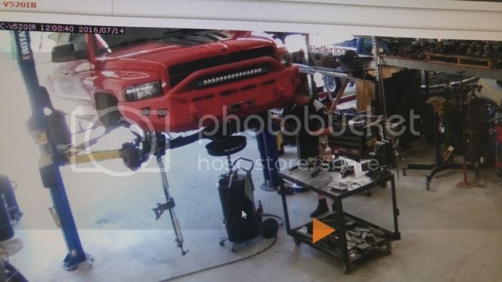

Trucks going into the shop tomorrow, the 35's are starting to take their toll on the steering. Ball joints are good still, which is a relief, but the tie rod ends and wheel hub assemblies have some play. Steering wheel is clocked about 15 degree's to the left, and it's starting to wander on some of the bumpier roads. Also going to have him install the diff covers finally and replace the fluid with some Amsoil synthetic. I've got a night run this Saturday night and the drive to get there is about 2 hours along some pretty curvy, bumpy, non maintained roads, and no time between now and then to get this work done by the weekend.
Luckily the tie rods are still under warranty, so no charge short of me paying my boss my coworker's labor rate to get the truck done during business hours. Wheel hub assemblies I've never replaced, so I got some Spicer hub assemblies to go on it.

Currently the truck is at my work’s shop up on a lift. Coworker is doing all the tie rods and wheel hub assemblies, along with installing the new diff covers. Pretty stoked to get it back and see if that solves the wandering issue. If not, then maybe it’s time to look at an AGR steering box for it, that way in the future I can add hydro assist when I’m ready to turn this thing into a full crawler.
