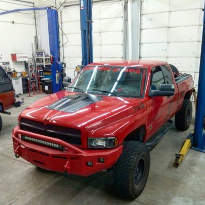

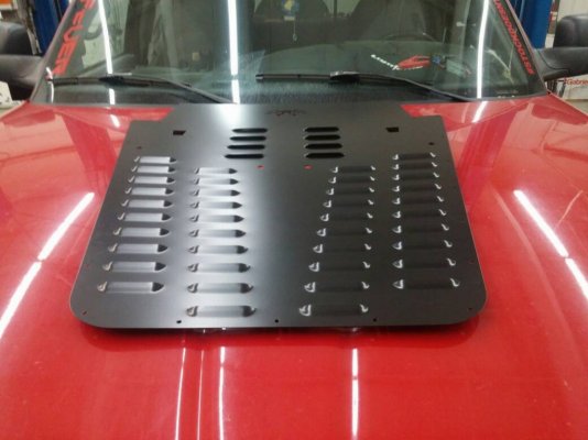

So i got the hood louver installed last night. I didn't get the hood cut out, at first i thought I screwed up and was supposed to print it off before installing. After research this morning i found that i was shorted that in the box.
But appearance wise i think it's great, really tied the front together. Here soon I'll pull it back off and make it functional. I'll be calling poison Spyder on Monday to see if they can send it out to me.

I had looked at doing the same thing glad to know someone else did it and it worked

Yeah man, 24 sheet metal screws and a criss cross pattern to install. Turned out sweet!

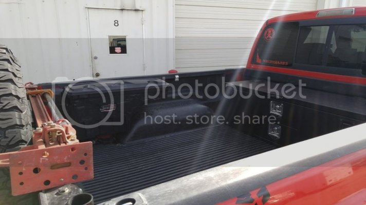

Alright so I've just been enjoying the truck as of lately. Not a whole lot has been done, I got the Smittybilt Adventure box bolted down this morning before work. Was a giant pain in the ass to get to the nuts on the bolts above the gas tank, but with a few adult words I got it haha.
So all my cargo solutions are done. All I've really got left now is to do the axe and shovel mount on the backside of the TireGate, then Monday the rest of my stuff will be here. Roto Pax 2 gallon fuel, 2 gallon water, locking mount and extension. I'll be mounting it to the I Rack above my license plate.
Was supposed to leave the truck last night to get the front end regeared and ARB installed, but my coworker doesn't have the time on Sunday to finish the truck up, and regear and locker with wiring to ensure everything is in working order is a 2 day job. I'm going to a wedding next weekend and we'll be taking the Burban, so my truck will be left at work Thursday night and my coworker said he can start on it Friday night and hopefully have it done by Sunday morning, which I should be home Sunday night so we'll just detour to my work and pick it up.

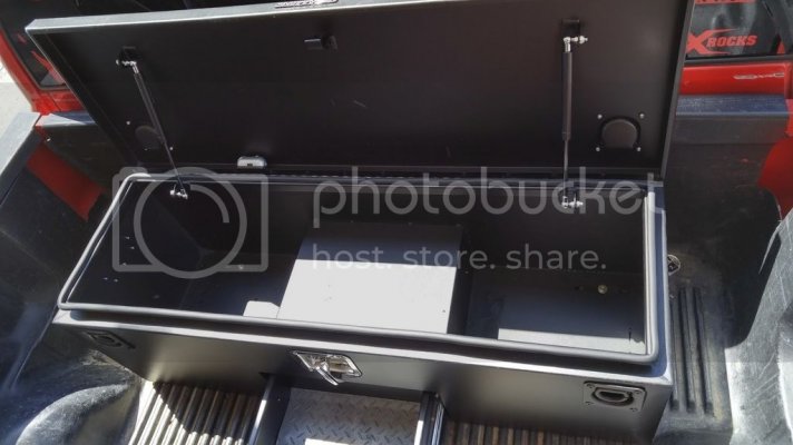

Pics of the storage.

I like the box at the front. Nice and compact, doesn't take up the room that the big chrome tool boxes do. Plus still get the tonneau cover

Both of the boxes are capable of going under a cover which is a plus. My main thing I like about it is the tie down anchors, and the fact that is has a separate drawer on it. I have the camper shell that I'm getting the ball rolling on building here soon, so I couldn't do a crossover tool box without having to remove it when I want to run the shell, so this is a nice compromise. I keep majority of my quick access stuff in the swing case, such as straps, small tools, etc. Then I have all my winch and recovery gear in the adventure box.
Photo wise I only have one photo to update with. I got the Roto-Pax installed. I have the water canister placed in the adventure box, I should have photo chopped something to see what it was going to look like. Hangs way to far off the back with both cans on, looks goofy and kind of an eye sore. So for now I just have the fuel can locked on, then when I go on trips and stuff I can add the water can whenever.

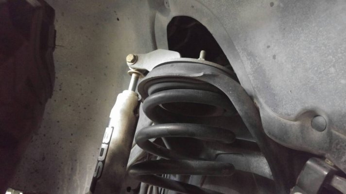

Now, onto a new problem. I noticed a leaking shock a while back, so I got a warranty replacement from BDS. Well, I've caught the problem. It appears the reason my front shocks keep leaking is because they keep getting smashed....by the coil bucket. So for now I'm going to go ahead and warranty exchange them out again, only this time I'm going to do some cross referencing and find some 2" body shocks that are similar in length and valved similar to get me by. When I install the Fox remote resi's once they're rebuilt and anodized red/black, I'm either going to try to modify the mounts to get the shocks further away from the coil bucket, or I'll notch the bucket. Last thing I want to do is smash one of these Fox shocks, as they're technically discontinued and the body's wouldn't be available to replace.

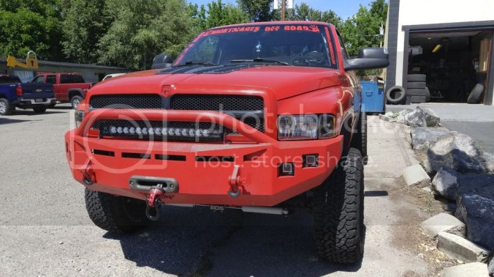

So update from this last weekend.
First off, I was a complete and ******* idiot. Went and did the 500 mile check on the front axle, after inspecting it I went to grab the ARB cover that's been in the backseat of the truck for months now just to realize I took it out earlier last week when I got the truck washed. So stock cover went back on, instead of using nice oil I used some 80/90 we had on the shelf. I'll do the cover in the near future and when I do that I'll refill with some Amsoil.

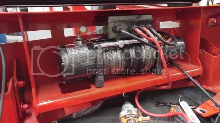

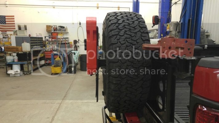

Onto other stuff now. I didn't get time to do the shocks. Instead I installed the winch and rewired everything for the Rigid Dually's in the bumper. Everything is done. Lights were fairly easy, for the most part it was making another harness for the SAE's to tie into the factory harness, then ripping apart the harness that was already there, removing the relay and wiring up the spots to the CTS2. Simple, but time consuming.

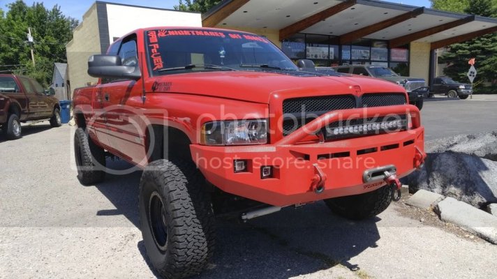

The winch was a royal pain. I had to build some new brackets for the controller to fit on top of the winch. I got it to clear the bumper, but I'm thinking I MIGHT do it again and relocate the box behind the grille like I should have in the first place. The wireless controller works fine, but if I ever have a failure or I need to use the wired controller, it's a real pain in the ass to get it to plug into the control box. The free spool luckily is easy to access through either the holes in the bumper, or real easy with the hood/grille open.
Anywho, after getting the winch in, I loosened up the brackets on the bumper and threw it on, then got it finally adjusted and positioned correctly on the truck. Really helped it out, looks a lot better.

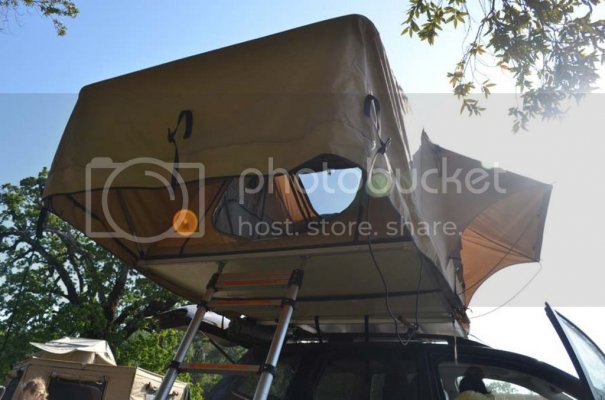

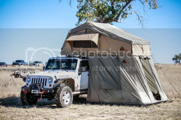

Third update is regarding the Rubicon trip. I keep jumping around on what tent or awning to purchase, and I’ve decided to make a transition again. Reason being is that Tepui Tents can get me everything I want at not only a cheaper price, but a better and easier setup for my situation.
1st is the tent. The Autana Sky is designed to come off the back of the vehicle, and the included annex has an opening for access to the rear of the vehicle. The tent itself also has an extended canopy entrance, which basically means when you climb the latter you’re not climbing into the side of the tent, but rather in from the bottom of it (pics will explain). With the extended canopy and supplied annex also means more "indoor" space. And, the annex has a PVC solid floor that can be removed for the open ground below (for showers or whatever), but can stay down for another 2-3 people to sleep in.
As for the awning, they don’t list it on their site which is the reason I called, but they have a photo that caught my attention. Basically it's separate room from the awning that attaches to the outer part of it. After talking to them, they discontinued it as they were having some issues with it, but currently they can custom build the enclosure depending on width of the awning, which will be the 6' one.
Basically what this does is leave one side of the truck open, which means I no longer need the same space as an RV to fully setup camp. I’ll have the tent positioned off the back as designed, the awning off probably the drivers side, the walls attached to the outside of the awning, then if needed I can put the mosquito net in the awning and make it a full setup.
Here’s some pictures of the ideas behind this.
Tent
Canopy for entrance
The awning with the separate room
And the mosquito net

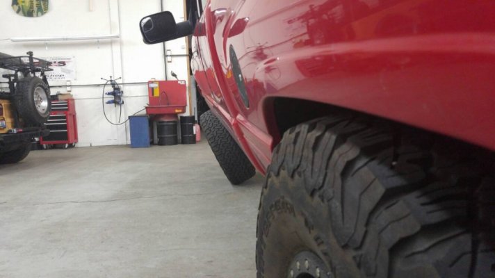

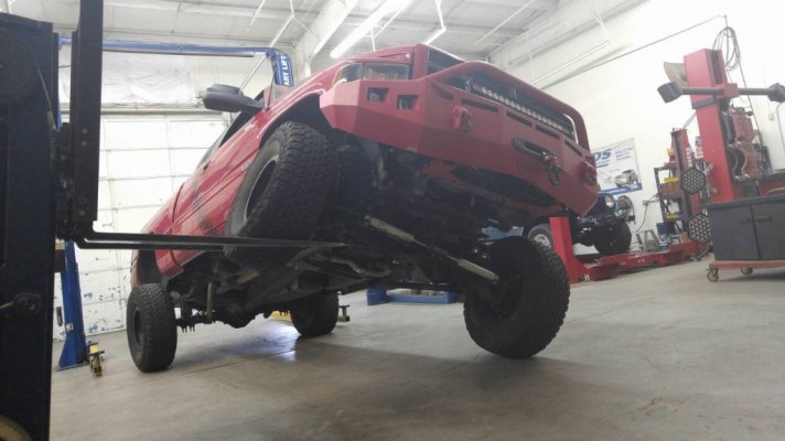

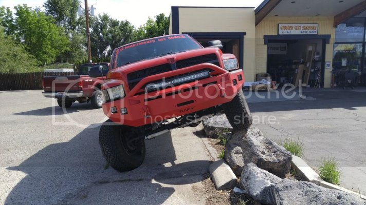

I guess the flexy pics would be nice to add here to haha

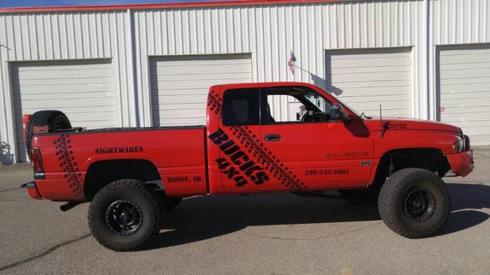

38" off the ground. Once i get the brake lines installed and shocks swapped I'll get a little more in the front as well
Also added the decals after work. Gonna pull the nightmares off that bed and go bigger and call it good. Turned out a lot better than i thought it would

I feel like I always come to this thread and just like posts on this fantastic truck while you write novels and share all your thoughts and plans. This, to me, is the most active and thought out truck build on this forum. Everything you do to it has a purpose and plan and it gets used like it should.
The tent looks like an awesome idea. I love those type of tents and I like the "porch" and "room" that go along with it. The pictures you posted look perfect especially if you will be carrying quite a few things and will have the family with you. Do they come with a foam pad or something already to sleep on?
The bumper looks great and the winch will be useful to have especially since you use your truck quite often as a recovery vehicle. I love the red pro link hook you put on there. Do you have a night picture with all your lights on? That would be cool to see.
Can the coil buckets be fixed with a little grinding or will it have to be something a bit more involved? Big flex problems.
Lastly, are you getting your new brake lines in stainless or just regular lines. Stainless would be awesome!
