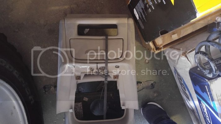

Update for the day. Console got delivered to my work today, it’s in fairly decent shape but I’ll have to change some things up. The front section where the console meets the extension is fairly small, so nothing will fit inside there the way I thought it would. So I’m probably just going to use some more lexan to fill the opening and make it appear somewhat decent. Thinking I’m going to wrap everything with vinyl when it’s all done. Wrap the console in vinyl that matches the gray of the dash, then wrap the lexan in black. I’m going to swing by the stereo shop probably tomorrow to see if they have a double din bezel that will fit around the stereo, I’ll attach that to the lexan so the stereo doesn’t look out of place. I’m thinking instead of putting the cell phone dock where the cigarette lighter goes, I’ll mount it to the lower lexan so it sits right below the stereo. Should turn out pretty cool.

But today I'm bringing home the console and stereo, gonna swing by the stereo shop for that double din bezel, grab some lexan or plexiglass from the hardware store, and find some vinyl from the fabric store on my way home. Then going to get the dremel out and start cutting to fit. Not sure yet how I'll mount the stereo in the console, but I'm sure it won't be too difficult.

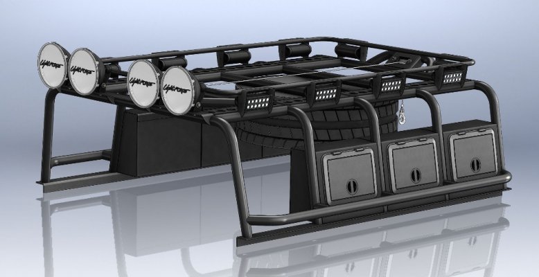

Finding a 60” rack I figured would be easy, but I spent hours last night browsing trying to find what I want. Then I saw it, kind of like when you see your soul mate for the first time and you just know….there she is. That’s the one. So I stopped looking. I officially, 110 percent know which rack I want.

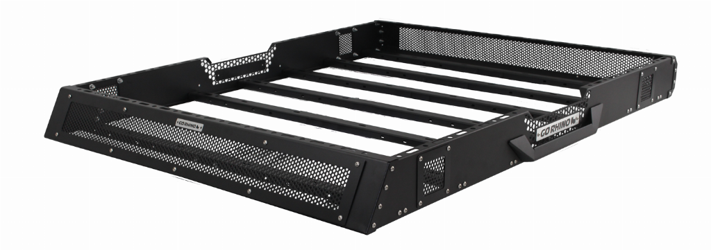

And here it is.

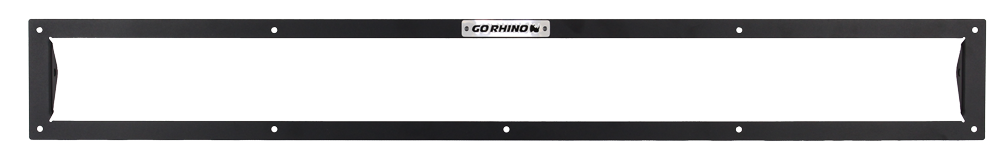

Go Rhino SRM100 series rack. It’s 60x48 inches, so it’s the perfect dimension for the top of the shell. It looks great, and it has all the functionality of the FabFours I was considering, without the extended cost, and the style matches my truck better. Did I mention it looks good?
Added accessories I'll be doing is the 40" front light bar mount, and the side plates for 3" lights.

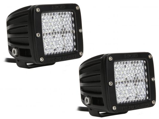

Lighting wise, going to steer away from Rigid for the time being. I don't want another Radiance up top, but I don't want to pay $1300 for a light bar. I do NOT want cheap though, so I'm optioning for a CSI 40" low profile series in a spot pattern. Side lighting I'm just going to go with the Rigid Dually Diffused lights

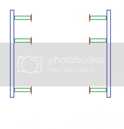

Moving onto the sliders and fabricating, I've decided I'm going to "half ass" my sliders and rear bumper builds. Not taking short cuts or jeopardizing quality, just getting them functional for protection for now.
Sliders will be simple for now. Starting with 3 steel plates, I'll line them up on the frame rails where I can put some bolts through, drill and temporarily bolt them on. From there, 2x2 square stock welded to them to make the arms, then cut off just below the pinchweld. To finish it up, 2x2 square stock from wheel well to wheel well welded to the arms, then rattle can it all black for the time being.
Red is steel plates
Green are arms
Blue is the slider itself
In the future, I'll add some 2" DOM tubing, and attach some bolt on steps that can be removed when wheeling.
Orange is the DOM tubing
Black are the bolt on steps

Have you seen the SRM200 I did the same thing but well above my price range.

Yeah I saw it, just not my style. I like the traditional looking racks. I'd love a Wildnerness Track Rack on my shell, but the Go Rhino I'm getting plus accessories (minus lights) is cheaper than just the rack itself from Garvin. Not to mention Garvin's stuff is popular in the Jeep world, I've never ordered a SRM100 series through my work, nor seen one running around town here. Not saying I'll be the only one, just one of few rather than one of many.

Yeah that's where I found them too but at $500 before discount it was to much for me to get but yeah I agree great looking racks

I'm fine with spending $500 for the rack, then $100 for the 40" light bar mount and $80 for the dually mounts. For $680 I'm getting everything, vs the Garvin rack itself is $679, plus they don't have free shipping so there's another hundred or more. Plus light mounts and more, it's easily a $900 rack by the time I get everything I want for it.

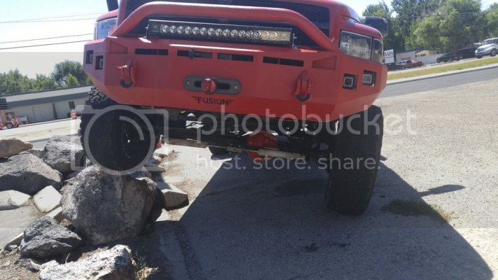

Had a few people ask me what the purpose of the comp cut is. Here's the easiest way to explain it.
This is a pretty intermediate sized rock that my truck's flexed on. It's also got 3 tires on the pavement. Now imagine actually out on the trails, there's a rock behind my driver's tire. There goes my bedside, or catch the bumper on the rock when progressing forward and twisting the bumper. Or both. The comp cut will give me better approach angles going either forward or backwards. The bottom of the new bumper will be where the small space between the top of my bumper and below the tail light. Below that will be all open.

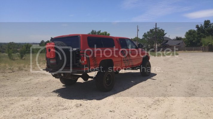

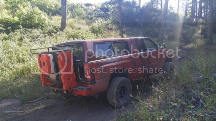

Also added some goodies Saturday while we were slow. Two 4 gallon Rotopax on each side. I don't plan on keeping them there at all times, so I think I'm going to order in 2 more extensions and do the black storage containers there as a full time deal, and when I'm going on a long trip I'll throw the 4 gallons on and extensions and mount the storage cans over the top of the 4 gallons.
Also went out to help recover that jeep Saturday instead of Friday. Forgot to grab pics of the Jeep, but it really wasn't that bad. She went off a small trail and got it off on some loose ground. Her dad's Super Duty was too big to get back on the trail close enough, but mine squeezed back pretty easily. Snatch block to a tree and winch hooked to her bumper got it pulled back up on the trail and got us both out. The first pic I posted shows the clearing she went through, then back through there about a hundred yards or so is where she got the Jeep stuck.

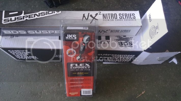

Another update for the day. Got my shocks and new sway bar end links in today. So Wednesday it's roof rack and suspension work time.
Sway bar endlinks are the new JKS flex ends. They have internal springs that allow for more sway bar play, which means for more intermediate trails I shouldn't have to disconnect anymore. More challenging and extreme trails, it's just like my current setup. Disconnect and swing up. I can also swap the internal springs out to make them softer or stiffen them up, so if it becomes an issue on the interstate I can go that route to make it more daily driver friendly.

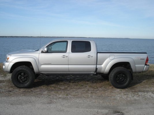

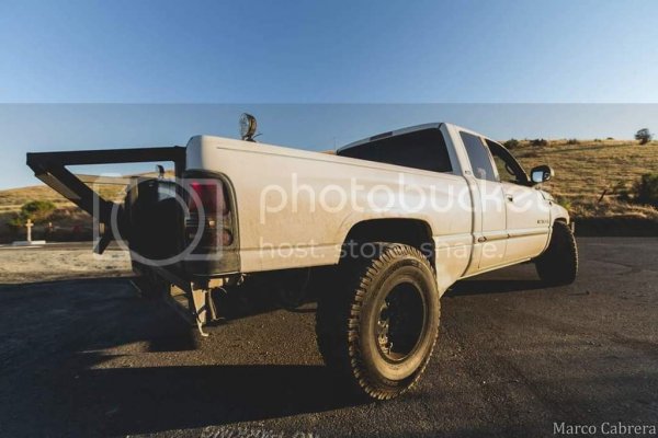

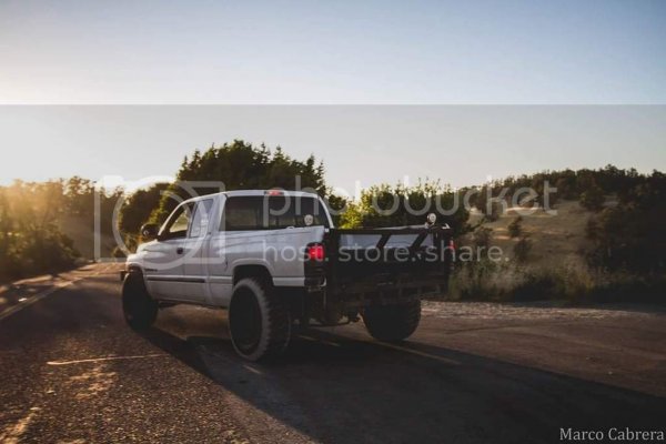

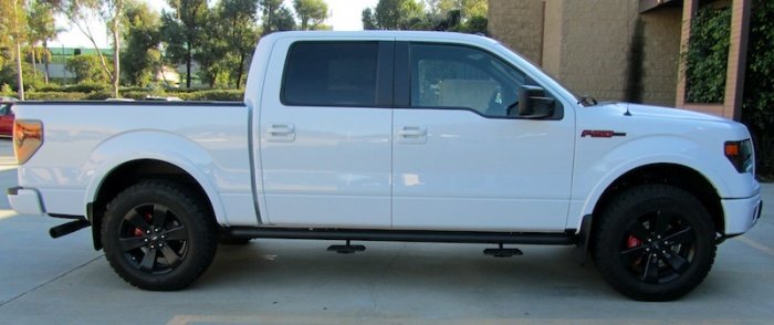

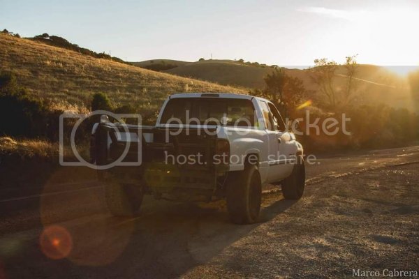

I also came across some pictures on the facebook of someone who did a comp cut just like what I'm planning. Gets me more excited to get this done.
NightMares
NightMares
Jun 27, 2015
1,214
927
Boise, ID
2001
5.9
Yeah, up to that first body line like that 2wd pictured

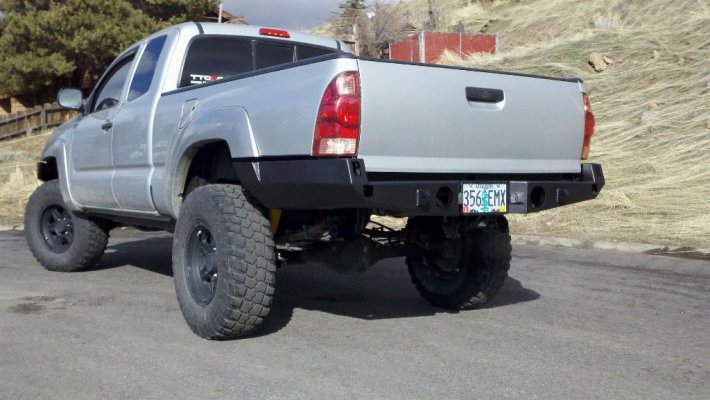

It's for clearance, and I'll clean it all up later on. I'm removing the rear bumper, and technically no the bumper is not the only location that can be hit when out on trails. If I come down off a rock, when the truck drops off the first location to hit will be the bedsides. Temporarily I'm going to mount the rear runner on the back of the bed to fill the gap between the hitch, this fall I will go through and build a rear bumper that has a slider going all the way down where the bed would have been. I was thinking tube style but just because it was simple and quick to build, but I'm already stretched for time right now so I'm just going through with the cutting for the time being.

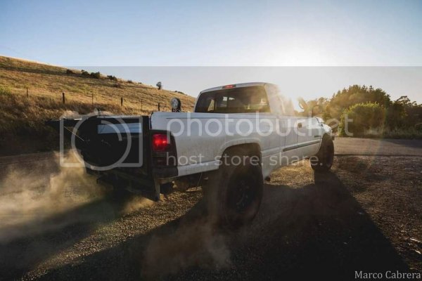

Here's something similar to what I'm going to build, only with no tail pipe. I'm going to cut the exhaust above the axle rather than run it all the way back, that way it's not in the way of getting smashed. The center that's shown on this bumper I'll have come down further, as I'm not removing my hitch off my truck, so I'll have it fit accordingly. Also, during this time and build of this bumper, I'm going to install the rear winch on the truck. Where the license plate is shown on this bumper is where my fairlead will be, as I already have my license plate relocated to my spare tire carrier. Mounting wise I'm just going to take a sheet of 1/4" metal and weld it between the frame rails of the truck, then relocate the winch control box between the winch and the bumper itself, and mount the plug for the controller flush into the back of the bumper.
And I'm going to add tail light guards that will tie back into my TireGate similar to this
So for a little bit here, yeah my truck's appearance might drop in some eyes, but the way I see it, it's either cut it now to prevent damage, or at least as much damage as possible. Or leave it as is and have the potential for more extreme damage.
This fall I'm starting the build back up hard on this truck, including the DOR parts, interior, rear bumper, potentially some motor work and more. I'm tearing hard into the safari shell, thinking of converting the windows to some hinged windows, like the back glass, and having a sliding deck that slides out each window on the side of the shell. From there I'll order in two sets of the 3 wall kits from ARB for the awnings, and have space for 4 people to sleep in a semi enclosed area off the ground. Inside the shell, I'm going to build an overhead shelf that's hinged towards the front of the truck that can swing down and allow access to goods, installing all the lights on the Go Rhino basket, and doing some interior lighting. Then the previous stated add on's, like the passenger side awning and roof top tent. I'm also thinking of ordering in a second touring room, with that done my truck will be capable of sleeping more people than it's actually capable of carrying haha. The touring room and mosquito room won't be compatible at the same time as the slide out's, but I'll have the option for people to sleep on the decks, or inside the touring room. This would be good for times when we end up camping in swampy or muddy situations, it will allow me to keep the bottoms of the touring rooms dry and not have to deal with mud for the remaining times of trips.
I want all this attached and tied into just the camper shell, that way when I start on the truck bed trailer build I can alternate between the truck and trailer when needed. Once I get this expedition trailer built, I'm going to start building some kind of a bed rack system that can again alternate between the truck and trailer. With this, I'll mount two more of the awnings on it, that will allow the shell on the trailer to have the slide out decks, awnings with 3 walls, and the rooftop tent. Then off the truck, I can do the touring rooms off each side, giving me the potential to sleep 6 people off the trailer, and another 4 off the truck alone.
Something like this, only without the spare tire. When I get this done, my swing case and adventure box currently in the bed of the truck will probably be thrown up for sale, as I'll build some boxes similar to what's pictured. I'm also just going to order in a second Go Rhino rack, my build will only be the tube frame and storage boxes, etc. That way I can leave the frame on the truck all the time, and install the rack itself when I'm heading out on trips. I still need to clear parking garages around here, at least until I have another daily driver truck, and storing both a LARGE trailer AND the bed rack would make things pretty difficult.

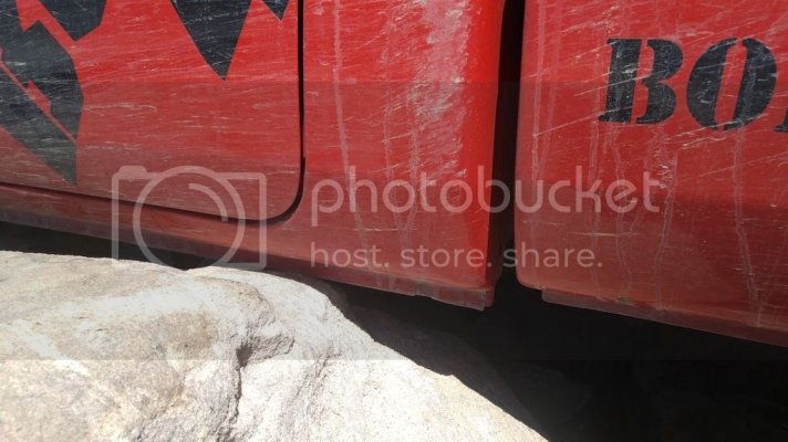

It's more common to see done on Toyota trucks, that white one I posted is the first time I ever saw it done on a Ram, short of that black one.
This is what the taco's are supposed to look like
Here's something people probably see all the time, but never really pay attention to it.

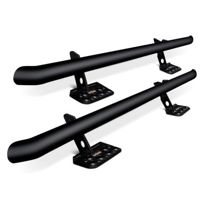

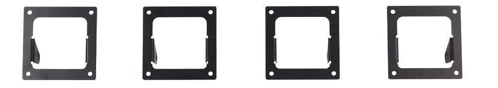

I also think I've come up with a decent solution for sliders. Talked to my rep with 4 wheel parts about some universal DIY sliders, and he brought up doing the N-Fab adjuststeps. The mounts for the steps are tucked up above the tube, meaning they won't get hung up on anything. On the 2nd gen rams they mount to the body mount bolts, so right off the bat they're already stronger than their counterparts that are rocker panel mounted. They're wheel to wheel already, so they'll cover the entire rocker section below the cab and bed. They're .083 wall 3" tube, so they're not the strongest for a slider, but they'll offer more protection than nothing. All I think I'd have to do is build the plates and arms from the frame out to the tube for extra strength, and that should take care of it. If they fail, then they fail. But this takes some weight off my shoulders as to building and starting from scratch, particularly because the wife throws a fit about climbing in and out without any steps on it at all.
Unfortunately, none of my work's distributors have them in stock, so my rep is going to call N-Fab first thing in the morning for an ETA on them and I'll go from there on whether or not I want to get them coming.
Here's some photo's of them for those who haven't seen them before.
