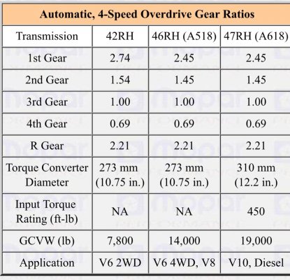

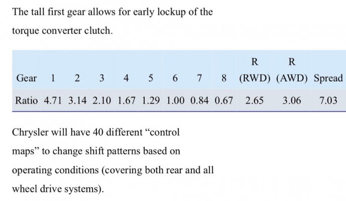

Let’s repost this here
And the approx ratios for an old school 727/A518 (which I have)
And a 545/645rfe in the other ram 1500’s
Like he said, the torque multiplication is already built into the 8 speeds with extra gears and much better spacing to-boot
I Bleed Ram Trucks
Man thank you for posting this. I have been looking for the 8 speed ratios do to a little math with. I'm genuinely curious what 5th gear looks like at 6000, if its close to that magic 5350 rpm on the ds

Chris, the 8spd 4th gear looks like our 46rh 2nd gear....
