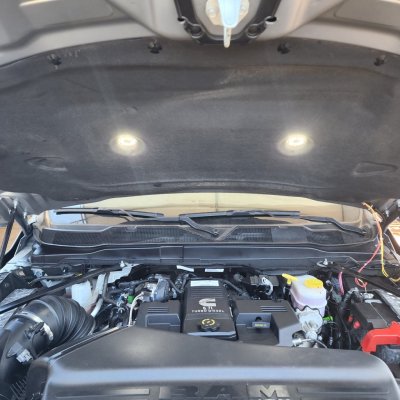

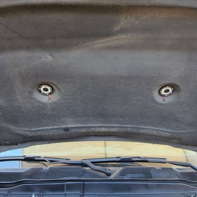

I installed those KC lights and connected them to an Aux Switch.
I did not buy the kit, I bought only the lights and did my own wiring. Other than getting those hood insulation retainers out the installation was easy peasy.
To the person who messaged me for pics
