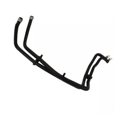

Do you think that a Inline Filter could be installed in the Coolant Hose, that is directly below the Air Intake Box ?
some of them may have a 3 way valve down on the frame

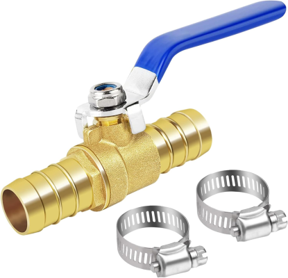

Remember when vehicles had one of these, to cut off coolant from entering the Heater Core ?

There was another valve, similar to the one above,
except it was shaped in a Small h
Coolant was able to go right up to the closed valve, but because it could not go into the Heater core, it was redirected over to the other hose & then returned to the radiator
I could not find an image of the h shaped valve :(
But many cars & had these, until around 2008

I remember when alot of vehicles had a valve similiar to this in the heater inlet hose,when you shut off the heat on the dash a cable from the dash control ran out to this valve and closed it,it also was the heat regulator for the interior,as you could adjust the valves opening.
