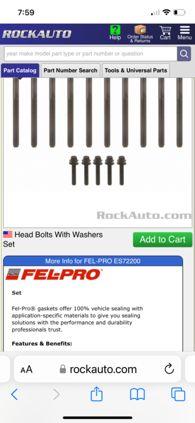

IMG_3112.pngI’ve just been wasting a little time looking online here tonight and I’m coming across a lot of conflicting information on whether TTY head bolts can be re used or not, but I’ve definitely seen enough posts saying absolutely not to reuse them so my question is, would these Fel-Pro ones from Rock Auto be ok to use? I’ve seen lots using ARP but they are like 500.00 which is way more than I want to spend. One thing I notice about the Fel-Pro ones is that the smaller bolts are all bolts where as the original smaller bolts 3 on one bank and 2 on the right bank are studs and not bolts. Could I just reuse the smaller ones along with the new Fel-Pro larger head bolts? I don’t believe the smaller ones are TTY,

I went ahead and ordered the new cylinder head bolts for peace of mind. I was doing some research trying to figure out this torque to yield business,I definitely don’t completely understand it, but I believe it’s basically if a bolt has been torqued to its maximum yield to a point it will not return to its original length then it has been torqued to yield. No difference in TTY bolts and torque to angle bolts, or bolts that are just torqued, basically just if a bolt is torqued to its maximum and doesn’t return to shape then it’s been torqued to yield. That’s my basic understanding of it anyways and I would have difficulty with the fact of losing a head gasket if I hadn’t purchased the new bolts.
