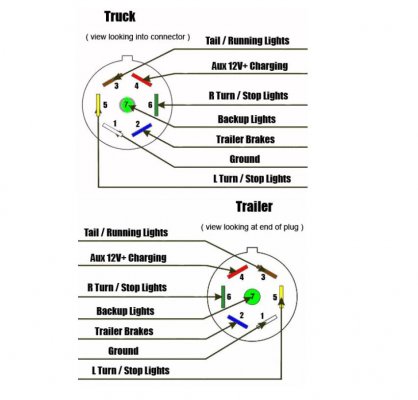

Are you using a good "7" pin adapter and not a 6 pin adapter? (next applies to my situation only) -- (U know they sell both and look identical. I use a "6" pin on my trailer, because trailer has no backup lights). If you have 12V at the proper pin, then it is a connector issue/trailer issue and not the truck. Easiest to check first.. BUY A new quality 7 pin connector and try that? If still no joy and you confirm you have 12V power, see diagram, then problem on the trailer side: (fuses somewhere, wiring, something). If you have things wired in, running in trailer, you need to check your fuse box and/or breaker panel in the trailer. heck, wiring from connector into box, could be bad, U just not know. You get to have fun troubleshooting, definitely watch some youtube videos, IMHO...
/// https://www.youtube.com/watch?v=n3uiTKtuluw ///
See if U can check and see at panel in RV if power making it to trailer breaker box? Could be bad grounds, bad "trailer" battery, converter, all sorts of You tube Videos on all that stuff, thinking outside the box, but hard to Internet Guessnosis if not there.

ADDED: On my 2019 1500 DT, I think that fuse is F01 on internal box, so U gotta look, if U want
  • 7 Way Diagram - AJ's Truck & Trailer Center.pdf
