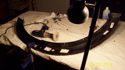

I had to use the eraser wheel. I clamped the flare down to a table to stabilize it and used spot light to see a little better. You have to be extremely careful because the wheel will eat through the plastic.

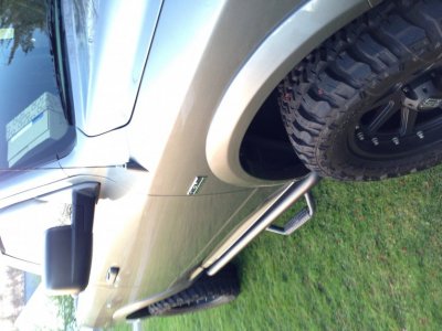

These are 2500 flares...
They came black like in the sig, then I had them painted to match.
